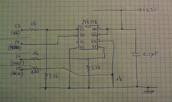

Hi everybody,
I bought some days ago an 1.8" TFT from arduino store (http://arduino.cc/en/Main/GTFT), it has a built in micro SD card reader and all is working fine. I can use the TFT and the SD at the same time without problem. Now I’m trying to attach to the same SPI also an SRAM (23K256) but something is going wrong…
If the MISO is connected to the pin of the LCD shield the SRAM stop working… If I detach the MISO pin from the TFT (needed by the shield only for the SD card) the SRAM will work correctly but the SD is unusable… The MISO is connected directly to the PIN 2 of the SRAM.
Another strange thing is that when the SRAM is working the TFT seem to be slower…

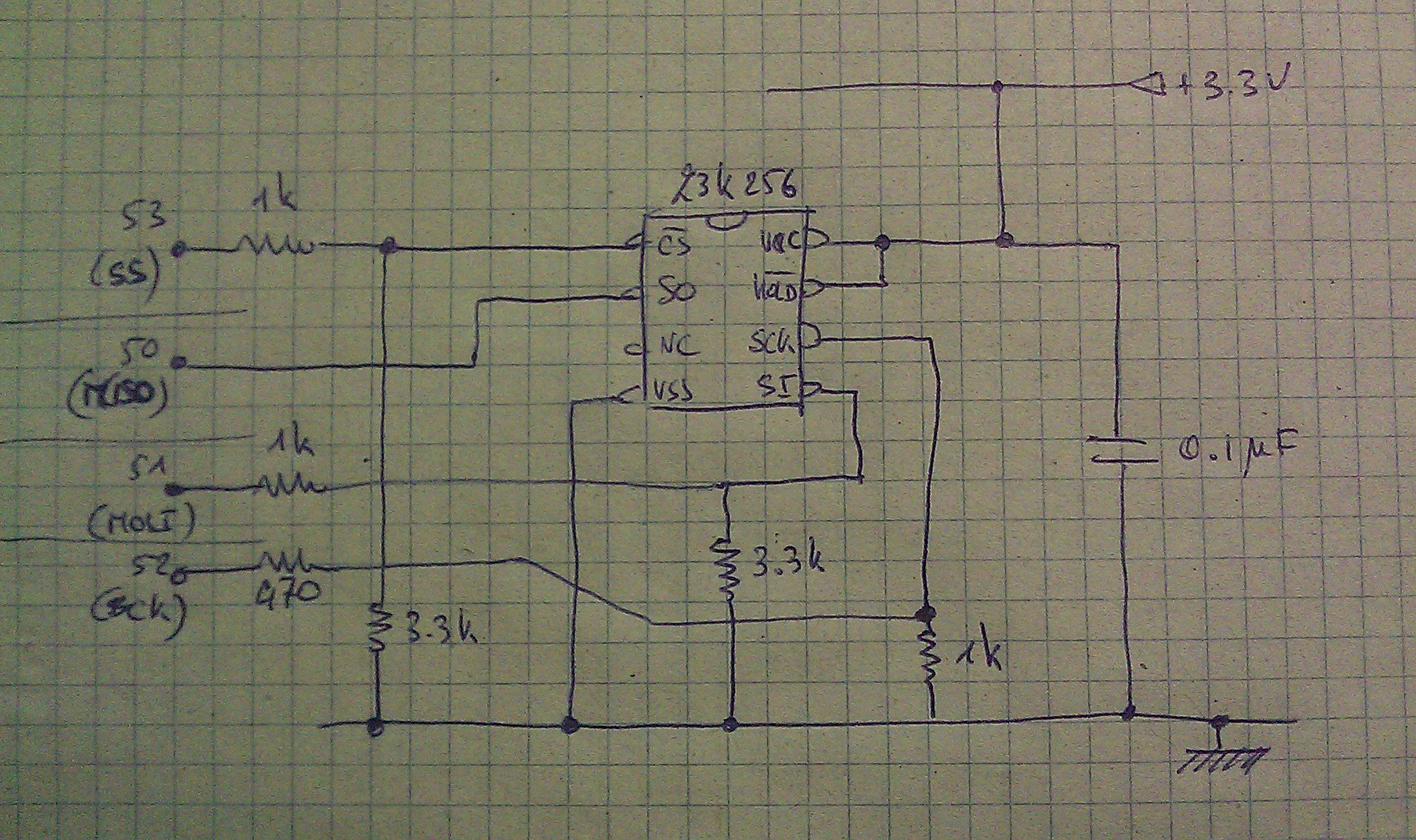

For the SRAM I used the attached schema (taken from the forum).
Any idea?
Thank you in advance.

How many SPI devices do you have and how many chip select pins do you have setup for them on your controller ?
raschemmel: How many SPI devices do you have and how many chip select pins do you have setup for them on your controller ?
Currently I have only the arduino GTFT and the SRAM, they are 3 devices (the SD card slot is included into the GTFT).
  • LCD (SS pin 7)
  • SD (SS pin 6)
  • SRAM (SS pin 10)
inode
  • LCD (SS pin 7)
  • SD (SS pin 6)
  • SRAM (SS pin 10

I see the SD & LCD chip select definitions but am not seeing any definition(declaration) for the SRAM chipselect on pin 10 in the code you posted. Is it there ? Please show me where you declare pin-10 as an SRAM chip select.

The pin 10 is defined into SRAM2.h (selectSS1).
#define selectSS1 PORTB &= ~0x04  //set the SS to 0 to select SRAM 1
Regards,
inode
Please forgive my ignorance but I don't have a lot of programming experience. Can you explain how the following:
equates to Arduino pin-10 as a chip select ? Obviously I am missing something. . PORTB &= ~0x04 => PORTB & 0x04 ? (PORTB [u]AND[/u] 0x04) What does the "~" mean in front of the 0x04 ? I am not seeing how ANDing PORTB with 0x04 = "10" (which would be 0x0A hex right?) Appreciate you help understanding this. Robert
raschemmel: Please forgive my ignorance but I don't have a lot of programming experience. Can you explain how the following:
Hi Robert, I didn't wrote the SRAM code you are reading, but this way to access to digital ports should be correct (see http://arduino.cc/en/Reference/PortManipulation for more info). The "~" operator is a NOT bitwise, you are working with port bits so you will bever see value "10". PORTB start from port 8, so 0x4 should be the PIN 10. I'm not a powerful user of arduino, but I think others people can confirm that.
Regards,
inode
raschemmel:
Read this:
http://ucexperiment.wordpress.com/2013/02/23/interfacing-microchip-23k256-32kb-sram-spi-memory-to-the-arduino/
I just implemented the code based on the link, but no changes. The SRAM will work correctly if the MISO is not attached and will be faulty if the MISO is connected to the TFT shield.
