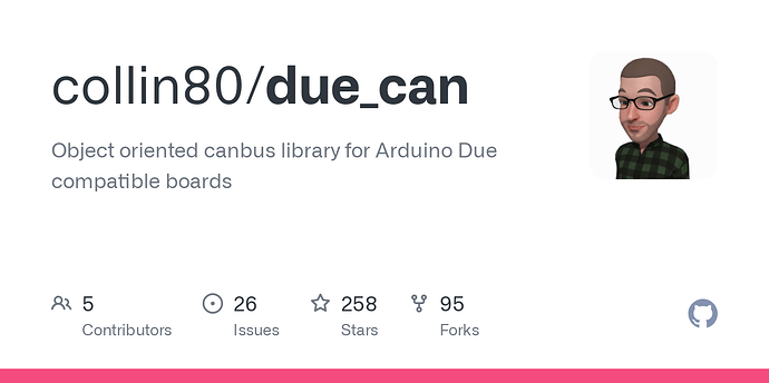

Hi @garygid
Here the library:
Here the forum thread about CAN ask there for any information(it is running from a long time, probably you would like to start by looking at the latest pages of the discussion)
http://forum.arduino.cc/index.php?topic=131096.0
