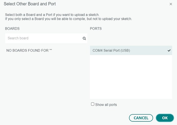

It was working at first, but stopped yesterday.
Windows 10 Home 22H2.
Rebooting doesn't help.

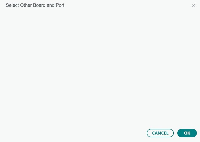

These screens alternate - then there are just no boards, then nothing at all.

While the IDE is displaying messages in the right bottom about "updating index ...", it will not know about the boards and hence can't show them. There is a known bug that will result in that process hanging till serial plotter (if open) and serial monitor (if open) are closed (in that sequence, close plotter first, next monitor).
Can you select a board and port using the tools menu while the IDE is in the non-functional state?

Through the menu the selection worked even when the window was frozen.
The failure is not stable, it is there or not.
I completely rebooted both arduino and windows that is all hangs should be reset. And I did not turn on the monitor and plotter. But it didn't help.
