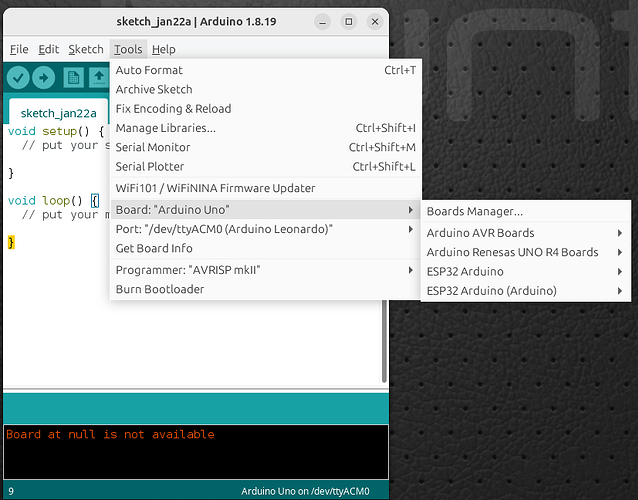

So I installed the 1.8.9 IDE and the Raspberry PICO etc toolkit. Configured the board. And there is no serial monitor at all. I compile the sketch, just working with the basic_callback sketch from the examples, forget about my own code for a minute. I upload the sketch (which I have to do manually using sudo, because for whatever reason Ubuntu locks up external USB interfaces to read-only unless root. I have a number of policies that are not my own, so maybe that's a side effect. Anyways. As soon as I upload the complied sketch and it gets going, I try to click on "Serial Monitor" and get an error that "Board at null is not available", whatever that means, never seen that before as the 2.3.x IDE just automatically reconnects when the board gets going. So in 1.8.9 the serial monitor just plain doesn't even work, let alone randomly freeze. Or at least I don't know where the magic buttons are.
Things are more manual on 1.8. Hopefully, doing the following will get you going.
  1. Start the IDE and select Tools/Board and your board type.

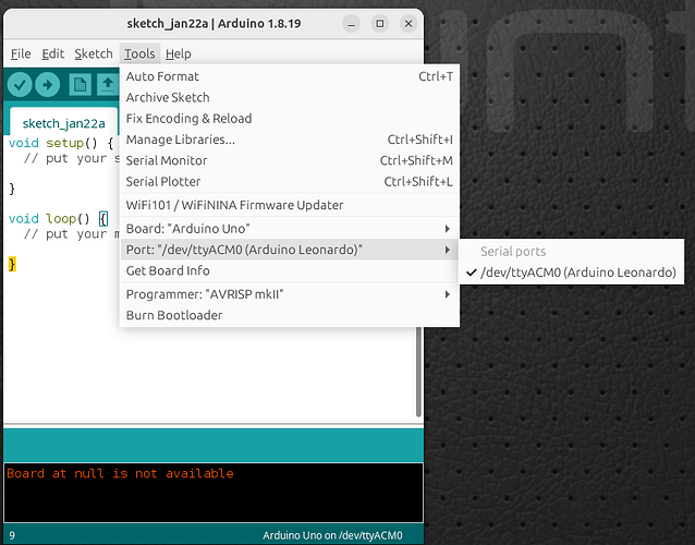

  1. Now, fromTools, select Port.
Now open the serial monitor.
If you haven't already done this, you will want to add your login to the dialout group.
Okay, got the serial monitor aaaannd.... same exact problem. If I stop pressing the NeoKey buttons for like 2 seconds, the monitor freezes. If I use the pull-down menu and change the baud rate, even to the same one as it was before, basically just simply use the pull-down rate menu, the serial output starts working again. Mind you, this is a canned example, "basic_callback" it is called. Not my own code.
