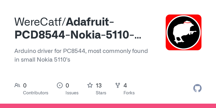

try
change
// pin 5 - LCD reset (RST)
// pin 4 - LCD chip select (CS)
remark line 87
Adafruit_PCD8544 display = Adafruit_PCD8544(12, 5, 4);
