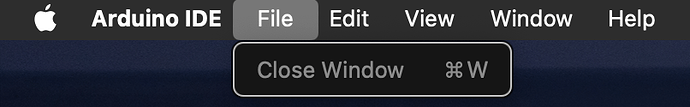

I have been trying to open arduino IDE for the past hour with no luck. Ive looked at countless posts here from people who had the same problem. Every time I launch Arduino It opens and I can see the toolbar, but there is no window that opens. I tried deleting it and downloading it again, which didn't work. I'm completely lost.

Can you post a screenshot as it's not quite clear (to me) what you see?

I am using MacOS: Ventura 13.0.1, to clarify; Arduino IDE will not run. When I start it, no window will open.

I'm having the same issue. Downloaded, opened, only those same options in the menu bar. No windows open, no indication of anything happening.

I am also having this issue. Below is the activity from the logs `
2024-11-14 16:16:26 2024-11-14T21:16:26.971Z root ERROR Failed to start the backend application:
2024-11-14 16:16:26 2024-11-14T21:16:26.971Z root ERROR Error: getaddrinfo ENOTFOUND localhost
    at GetAddrInfoReqWrap.onlookup [as oncomplete] (node:dns:108:26)
2024-11-14 16:16:26 2024-11-14T21:16:26.971Z root ERROR Uncaught Exception:  Error: getaddrinfo ENOTFOUND localhost
2024-11-14 16:16:26 2024-11-14T21:16:26.972Z root WARN The local plugin referenced by local-dir:/Users/spawnofbill/.arduinoIDE/plugins does not exist.
2024-11-14 16:16:26 2024-11-14T21:16:26.972Z root WARN The local plugin referenced by local-dir:/Users/spawnofbill/.arduinoIDE/extensions does not exist.
Can you ping localhost?
