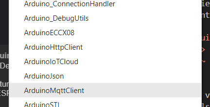

What is even more strange that the library is listed in Arduino library menu...

Here is Include library menu:
