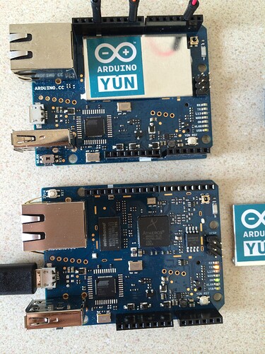

What’s under the silver cover?
PCWorxLA:
Jming: why? learning is from building, not just from books
The complexity of a device like the Yun is simply beyond what you can "do it yourself". All learning aside, I could just not see me wasting any time on even trying to source all the parts let alone trying to solder this together, considering that these are mostly SMT parts...
Ralf
Well, complexity for some~~~, for others, it's an opportunity to move forward. I was just curious about what was under the silver cover. After carefully cutting the two soldering points and taking away the cover, everything just works fine. No, not fine, it's even better. The average signal strength rises from 52% to 63%. I really need the answer why arduino wants to hide the information of Yun and change their promised attitude, "opensource". They use cover, refuse to put the EAGLE(brd or .sch) files in public, and not even release the AR9331 mapping.
