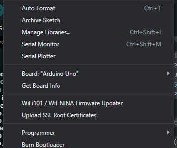

But on my computer it start loading the connected and disconnected sound repeated over and over and after that there was no port selection on Arduino IDE.
Do anyone have any idea why and how to fix it?

but even before i plug it in it doesn't give me the port menu

I don't think it a uno problem because here
