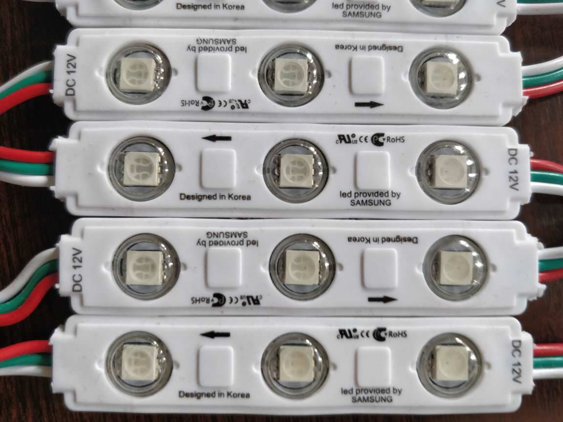

What voltage is your LED strip?
5V or 12V.
Can you post a link to where you bought them please.
Thanks.. Tom.. 🙂

Hey Tom,
The WS2811 strip takes 12V.
I bought them at a physical store so I can't really find pictures of this online.

Diagram from post#7 seems correct, assuming you have a 12volt/1Amp regulated supply.
The strip shown in post#10 could use 20\*0.06A = 1.2Amp full white, so careful with max brightness.
Power the Arduino from a separate source (e.g. USB) for now.
You can connect 12volt from the strip later to the V-in pin, to power the Arduino from the strip supply.
Note that a 12volt strip has no individual LED control, only control per three LEDs.
So set the number of LEDs in the sketch to 20 instead of 60 for the strip on the image of post#10.

In fact ATTACH your image file rather than rely on an off forum location.
OPs LED strip.
 ![3G7WF7I.jpg](https://europe1.discourse-cdn.com/arduino/original/4X/a/9/1/a912ba8ef5eb7c748d9e7dd138d4b53c587fe46a.jpeg)
Tom... 🙂
