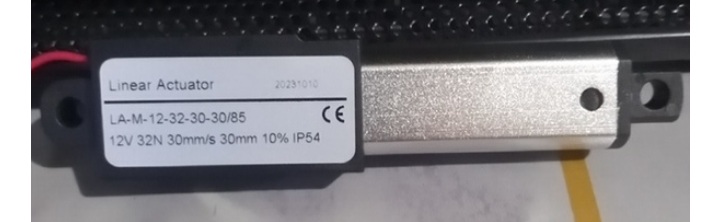

 ![Screenshot_20231110-181732_Chrome](https://europe1.discourse-cdn.com/arduino/original/4X/7/b/3/7b359165ed0060eb140468d3f9bc84d9515c2135.jpeg)
This is the actual linear actuator i have. Though it is 12V i could run it with a 9V direct to the battery.
Yes the rover will be powered by 2 li ion batteries

A quick look for that actuator quotes running power as 3W.
P = V \* I so... I = P / V
I = 3 / 12 = 250 mA.
Can you measure the resistance of your actuated motor and then calculate the stall current.
> [@addieee24](#):
Set up to what supply voltage?
Thanks.. Tom... 😀 👍 ☕ 🇦🇺

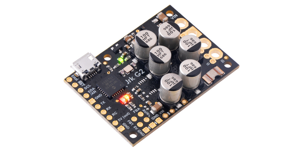

> **[Pololu - Brushed DC Motor Controllers](https://www.pololu.com/category/10/brushed-dc-motor-controllers)**
> Take command of the speed and direction of your brushed DC motors using these controllers. This category includes single and dual serial motor controllers with a variety of features such as analog, RC, or USB control, speed/position feedback,...
> [@addieee24](#):
> I want the linear actuator to extend when the rover is not moving and retract after 15 secs.
As I said before that is a simple matter of software.
