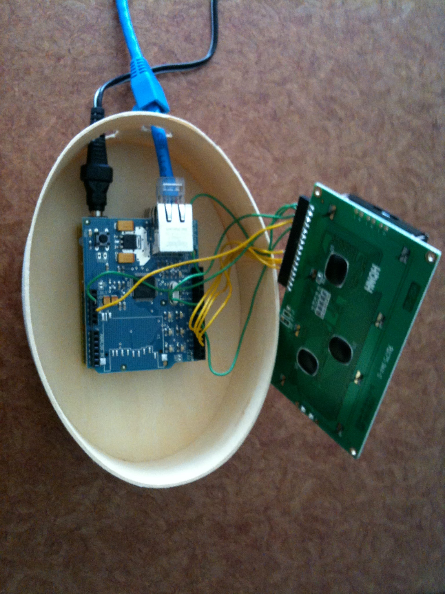

I first connected the Ethernet shield to the arduino uno and then connected the lcd (same one as in the instructables demo). I shifted down the lcd pins like it says in the instructables and ran the "hello world" example from the IDE and it worked brilliantly.

Hey, ive got my code working (as i can see the ouput on the serial monitor) but it won’t display on the lcd
can u help me please :slight_smile: …im using a 16x2 lcd
i have no idea on how to get the String object displayed onto the lcd
here is my code
