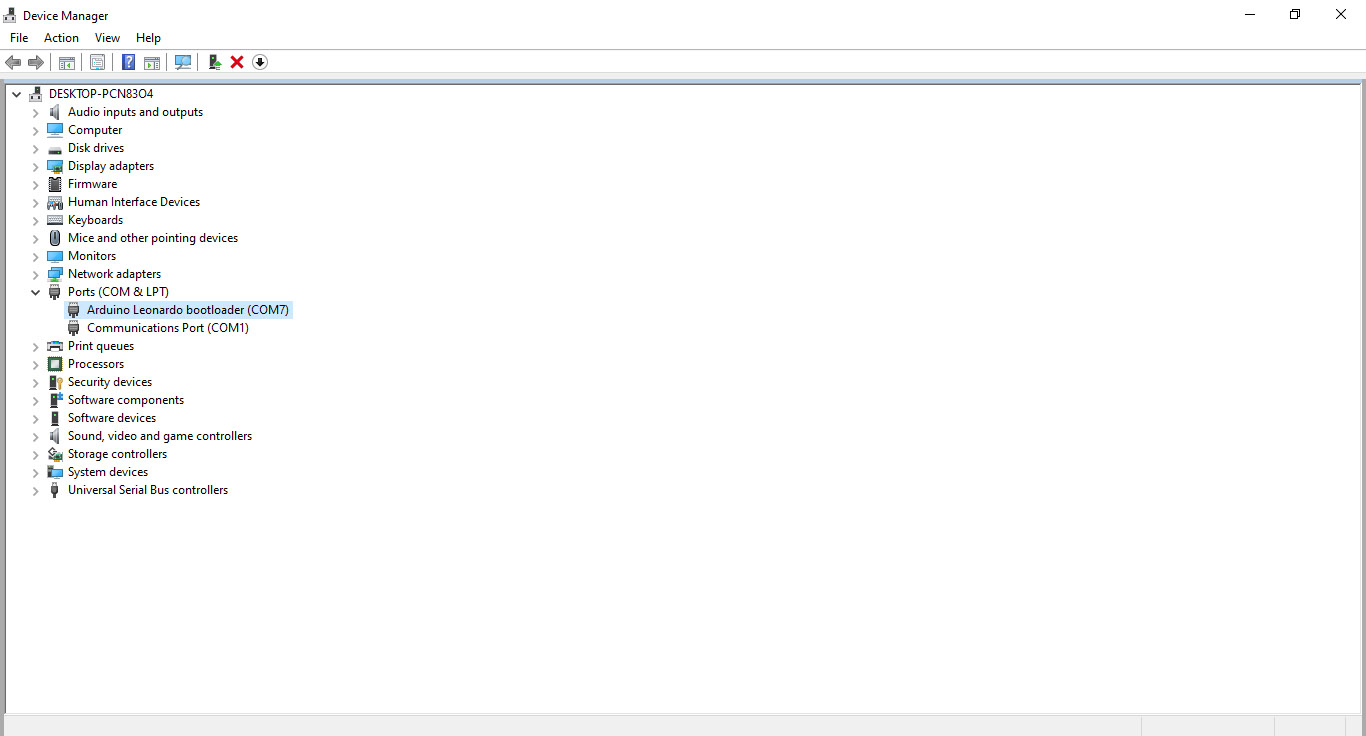

My arduino is not detected by the computer With the LED flashing for the letter L
 ![11111111111](https://europe1.discourse-cdn.com/arduino/original/4X/7/8/b/78b7fb51db380140979983d34226afe6760f980c.jpeg)

> [@eslamalumital](#):
Is it flashing or pulsating?
Did it work in the past?
Have you tried to upload a basic code like the blink example? What were the results?
I do not see how your topic relates to Sensors and hence it has been moved to a more suitable location on the forum.

Flashing is slow and it was working fine. I did not try to download basic code. Please solve
It **is** detected ( running the bootloader ). Did you try to upload a sketch?
> I thought he had something to do with it.
Who ?
> Yes, the picture is from my personal device
So your Leonardo is running the bootloader and detected as such. It awaits that you upload a sketch. You can try with one of the examples in the IDE.
The Leonardo is different from e.g. the UNO, as it appears as different devices depending on whether the bootloader or a sketch is running.

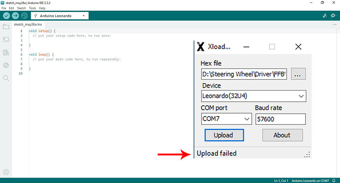

The problem persists even when the cable is removed and installed, even when the programmer button is pressed

You cannot Upload a cipher (Post No.9)

I rarely use IDE 2, but never saw this Xload window. How do you upload? Simply try the upload button on the upper left corner ( right arrow).
