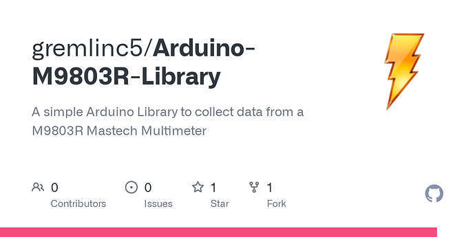

Hi, all.
This is my first post and my first library.
M9803R Library permit to collect data from a M9803R Mastech Multimeter, if you want it follow:
If you find some bug add an issue on github.

uint16_t _u16BaudRate; ///< baud rate (300..115200) initialized in begin()
115200 does not fit in an uint16_t
Hi
thank you for your interest, M9803R Multimeter works only at 9600 baudrate so that is not so important ![]()
I will remove that and don't let user to select a baudrate.
Cheers.
and adjust the comments accordingly ![]()
will have another look (I don't have such a MM so my remarks will be on code only)
