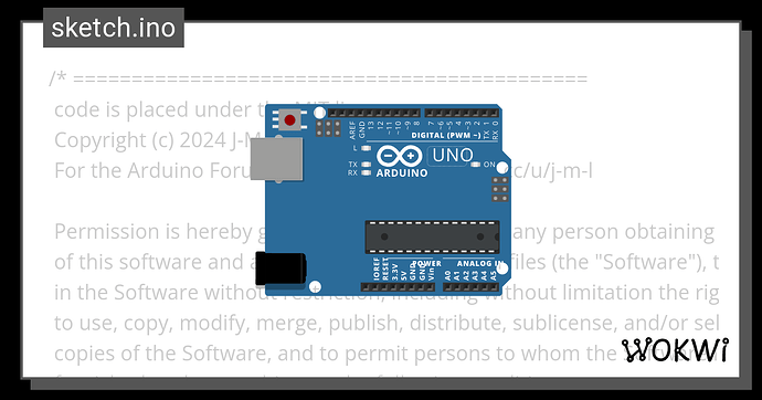

I had a bit of time, so here is an example you can try in wokwi
you can't send binary with the wokwi serial monitor but your start maker can be obtained by sending the YEN ¥ symbol. So you can engineer frames just using ASCII that will work.
try sending ¥XYZab1¥XYZac0¥XYt12w for example. Those are 3 frames with proper start marker and checksum.
For example the first frame is ¥XYZab1 where ¥ is the start marker (will send 0xA5) then XYZab is the payload and the cksum of these 5 bytes is the ASCII code of 1 so ¥XYZab1 will be a correct frame.

// test with "¥XYZab1¥XYZac0¥XYt12w" which will match the frame format for 3 frames
const byte startMarker = 0xA5;   // Start marker
const byte payloadLength = 5;    // Length of the payload
byte payload[payloadLength];     // Buffer to hold the payload
byte payloadIndex = 0;           // Current index in the payload buffer
enum State { WAIT_FOR_START, RECEIVE_PAYLOAD, RECEIVE_CHECKSUM, PROCESS_FRAME } currentState = WAIT_FOR_START;
void processSerialData() {
  while (Serial.available()) {
    byte incomingByte = Serial.read(); // Read the incoming byte
    switch (currentState) {
      case WAIT_FOR_START:
        if (incomingByte == startMarker) {
          payloadIndex = 0;              // Start a new frame
          currentState = RECEIVE_PAYLOAD;
      case RECEIVE_PAYLOAD:
        payload[payloadIndex++] = incomingByte; // Store payload byte
        if (payloadIndex >= payloadLength) {
          currentState = RECEIVE_CHECKSUM;
      case RECEIVE_CHECKSUM:
        { // compound statement needed because we define a local variable to this case
          byte cksum = 0;
          // Calculate checksum
          for (int i = 0; i < payloadLength; i++) cksum += payload[i];
          cksum ^= 0xFF;
          // Verify checksum
          if (cksum == incomingByte) {
            currentState = PROCESS_FRAME; // Move to processing state
            Serial.println("Checksum error");
            Serial.print("Calculated Checksum = "); Serial.println(cksum);
            Serial.print("Expected Checksum = "); Serial.println(incomingByte);
            currentState = WAIT_FOR_START; // Reset state machine
      case PROCESS_FRAME:
        Serial.print("Frame received correctly: ");
        for (byte b : payload) {
          if (b < 0x10) Serial.write('0'); // Print leading zero for single-digit hex
          Serial.print(b, HEX);
          Serial.write(' ');
        Serial.println();
        currentState = WAIT_FOR_START; // Reset to waiting for the next start marker
  Serial.begin(115200);  // Initialize Serial with baud rate 115200
  Serial.println(F("ready"));
  processSerialData();   // Call the function to process serial data
  // here you can do other stuff
