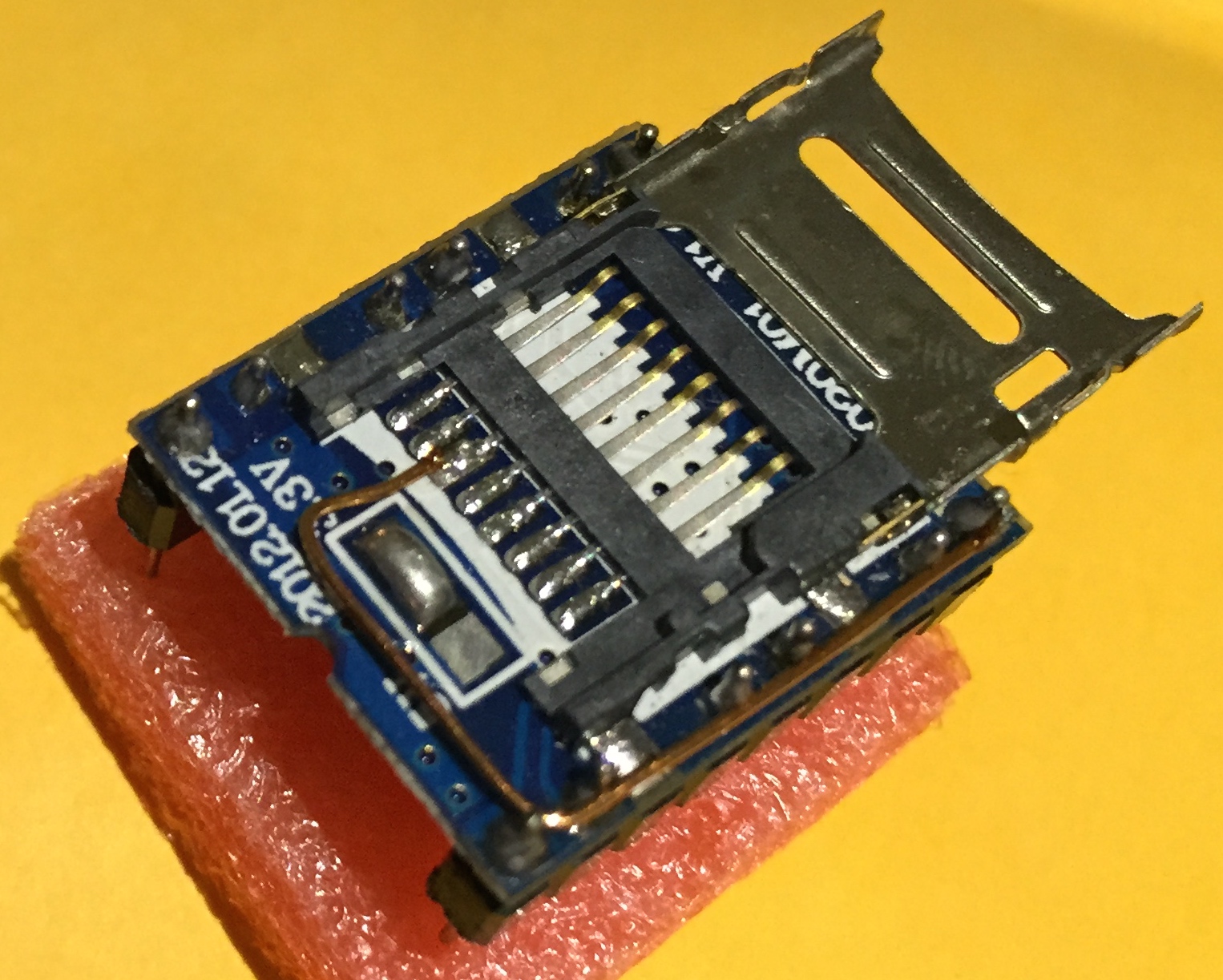

Problem and Solution:
When I first attempted to get a WTV020-SD-16P to work, I like many people had issues. I tried several board and several 1/2GB microSD cards, until eventually it worked, but not sure what the magic was, put it down to voodoo.
The Problem:
However a discovery (from a like minded builder) is that the SD Card Pin 6 (on the board) is not properly connected. The Spec (for Pin 6) says that it should be connected to GND, but it isn't!!! at least not in the boards that we tested.
The solution:
The solution is to connect a wire from Pin6 of the SD Card socket to Pin 8 (GND) of the sound module. As I said I cannot take credit for discovering this. See this post showing the wire that was added.
http://www.tonymacx86.com/imac-mods/130197-mactester57s-imac-g5-17-a1058-model-7.html#post986109
And here is the same modification I did to my own board
https://www.dropbox.com/s/ncp4wbbuirimjem/IMG_3512.jpg?dl=0
The question is: Is this a design/production fault present in all boards? or just isolated to some boards?
Can anyone test their boards, by using a multimeter to check for continuity between Pin 6 (SD) and Pin 8 (module), and report back ?
If after making this modification can anyone report success with SD cards other than the limited once that are known to work ?
Thanks.

Hi kiwisincebirth,
So you think you fixed it after adding GND to the SD card or you are not sure what fixed it? Can you disconnect the GND wire and check if it still works?
thank you.
I'd like to know that too because i spend many hours trying to make it ever get out a bip but nothing
