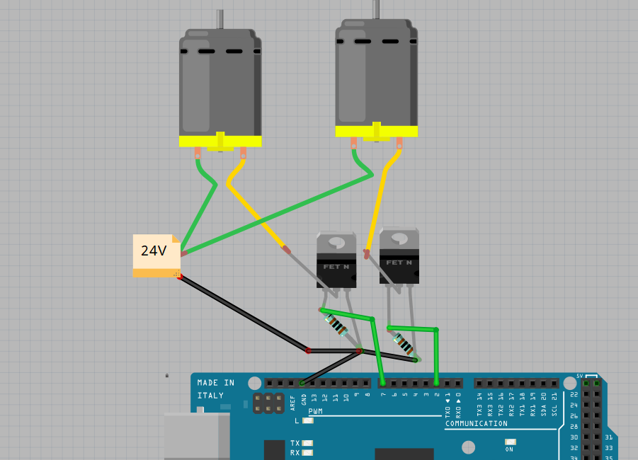

I'm controlling with 2 MOSFET my 24V source to power 2 motors as you can see attached.
When I do a digitalWrite(HIGH) it works fine ...
But then the digitalWrite(LOW) make the whole project bug ....
I have define the 2 pins ( 7 and 2 on the schema ) on OUTPUT
This drive me crazy !
It's because the two mass sources aren't linked ?
I don't see any back-emf diodes across the motors.
That could cause problems, and even destroy the mosfets.
See this page, first diagram.
Leo..

You certainly require diodes across the motors, and you should give full info on
power supply, motors, MOSFETs...

Always for every motor, relay, solenoid, anything inductive. Cathode to positive supply.
How could this possibly make my arduino buggy ?
Because of the high voltage spikes flying about if you don't use them - can cause substantial
interference to low voltage signals.
The diode just needs to handle the voltage of the supply, and be pulse current rated for the current
through the load. Any diode type will work, its not critical, unless using fast PWM.

Change Rgs to 10K, 100R is too low, you only want to make sure the gate is at source potential if the gate circuit is open circuit.
100R will be drawing excessive current from the controller, 5 / 100 = 50mA, the outputs are only rated to 40mA.
Also fit the 220R resistor in series with the gate.

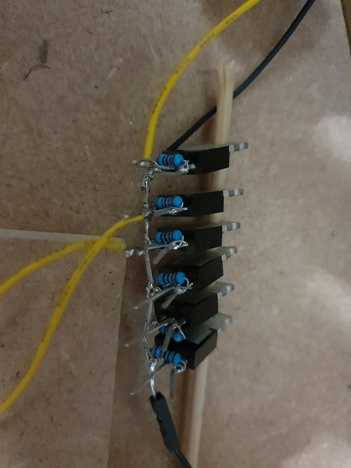

I just looked back to my circuit (already soldered of course) and ... I must have been drunk while doing it 'cause I have 1KOhms AND 10KOhms resistors !! God damn it !
Does it changes something to have some with 1K and others with 10K ?
Does thoses diode will make it then ? :slight_smile:
Here's a picture of the "motors controlling part" already soldered ( Yes, I know I told you there was 2 motors but there's 6 actually ^^' )

R2 could be 1k or 10k, but 1k would sink ~5mA where 10k would sink 500μA.
