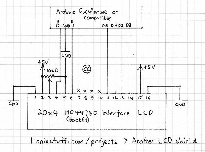

How Do I Connect My Mega TO My 16 Pin LCD Display, Every Diagram I Find Is Aduino Uno, And The Pins Are Different On Mega. Do I Still COnnect Them To Pin 12, ETC, Or Do I Connect It To Digital?

here is the page i used when connecting my Mega R3 to a 16 pin 20 04. If it is using a 16 pin input the controller should be the same and work for you as well.
http://tronixstuff.wordpress.com/2010/07/11/lets-make-another-arduino-lcd-shield/
and specifically this image.
