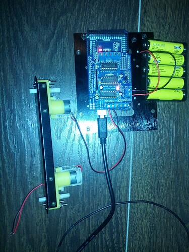

I unplug the L293D driver chip and connect directly to arduino, battery pack and motor, and use the pin 9 to enable 1, pin 4 to input 1, and pin 3 to input 2, then i run this code:
const int motor1Pin = 3; // H-bridge leg 1 (pin 2, 1A)
const int motor2Pin = 4; // H-bridge leg 2 (pin 7, 2A)
const int enablePin = 9; // H-bridge enable pin
{ // set all the other pins you're using as outputs:
pinMode(motor1Pin, OUTPUT);
pinMode(motor2Pin, OUTPUT);
pinMode(enablePin, OUTPUT); // set enablePin high so that motor can turn on:
digitalWrite(enablePin, HIGH);
digitalWrite(motor1Pin, LOW); // set leg 1 of the H-bridge low
digitalWrite(motor2Pin, HIGH); // set leg 2 of the H-bridge high delay(1000); // set leg 1 of the H-bridge high
digitalWrite(motor2Pin, LOW); // set leg 2 of the H-bridge low delay(1000);
And motor run, but very slowly((( Why? I connect battery pack red wire to Vs, and black wire to GND.
This is the photo.
Then, i connect Enable 1 to +5V from Arduino, Input 1 to +5V from Ardiono, and Input 2 to GND, and motor run fast!
What do you think, this is ardiuino' s problem? Or L293D chip is bad?
