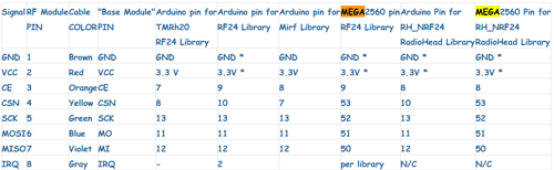

I am using nrf24 base module, I have nrf24 antenna and non antenna versions. I use base module so I didn't do this 100uF soldering between ground and 3.3v on the nrf24, I connected nrf24 on the 5v because I use base module. I read the tutorial given here in detail https://arduino-info.wikispaces.com/Nrf24L01-2.4GHz-HowTo. Apart from these I checked other tutorials too but my main problem always happens in the Arduino Mega that nrf24 and mega don2t communicate at all. However, arduino uno is working very well.
I connected CSN to pin 53 ( CSN's other name is SS - slave select ), SCK to pin 52, MOSI to pin 51, MISI to pin 50 at my arduino mega.

You have not said what pins on the Mega your nRF24 is connected to. MOSI, MISO and SCK are in a completely different place on a Mega compared to an Uno. See here
I have no problem using an nRF24 with a Mega.

I connected, CE to pin 9, CSN to pin 53 ( CSN's other name is SS - slave select ), SCK to pin 52, MOSI to pin 51, MISI to pin 50 at my arduino mega. I was shared what pins I connected with a screenshots ).
I believe that I do the connections correctly but why it doesn't work ? I use original arduino mega too.
That seems correct.
Have you tried the examples in my tutorial?
Your photo (in Reply #2) seems to show a lot of stuff connected to the Mega as well as the nRF24.
Have you tried using the Mega on its own with the nRF24 as the only thing attached?

I have a usb shield on my arduino megA to control my logitech extreme 3d pro joystick ( I want to send my joystick data to 2nd arduino to make my robot move ).
I power up nRF24 with arduino's ( 5v ).
When I click to T in serial monitor nothing appears. In addition, I even tried the older library of maniacbug's library too and it gives everything as zero too like this:
Shortly, no communication at all between my arduino mega and nrf24. I use ARDUINO 1.8.5 version ( latest version ).
I want to ask one more thing. With one nrf24 on arduino uno will act as transmitter and that transmitter can communicate with other x2 receiver of other two arduino uno(s) , is it possible ? I am going to give up using arduino mega really, it made me mad, even I do everything correctly, it doesn't work...
Robin2, I took off the arduino usb host shield and it has started to work >:( ... But I need that usb host shield for my logitech control too; so how can I use both of them at the same time now ? :o

I don't know the answer to that. I have never had a host shield and I don't know anything about it.
Maybe it also uses SPI for communication?

I found this topic that shows how to use nrf24 with ethernet shield ( I never used or tried an ethernet shield myself too ) which thy use the same SPI. It seems that the usb host shield has same issue with nrf24 too.
I download the said library from here GitHub - greiman/DigitalIO: Fast Digital I/O, Software I2C, and Software SPI for AVR Arduino ( ast Digital I/O, Software I2C, and Software SPI for AVR Arduino ).

Shortly, how are we going to use this " DigitalIO " library with nrf24 that usb host shield and nrf24 will not block each other ? I am confused now.
I tried these pin configuration alone itself on my arduino without connecting the usb shield and nrf24 doesn't work with that pins.
