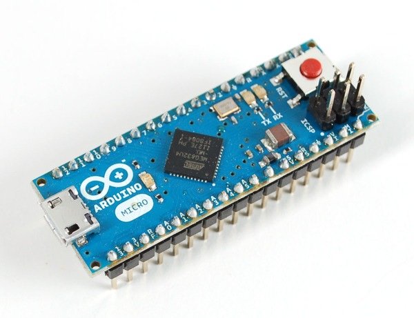

I am trying to find a socket so that I can pop an Arduino micro onto a PCB, I have pretty much figured everything out but the only socket I can find that might fit will take 10 weeks to ship. I really don't want to solder the micro onto the board....
Just use male/female header strips. Snap them off to the right length.
yea I thought about that, concern is them bending, I have seen in the past a socket for the SB2 microcontroller for just this purpose. I won't go into why I dont want to use the Stamps anymore but I was just hopping there was a similar product for the arduino micro.

The headers on the picture are Turned pin "Tulip"-connectors. You cannot fit the male headers of the Arduino in these connectors.
The right thing is these: http://www.ebay.com/itm/221157400503
