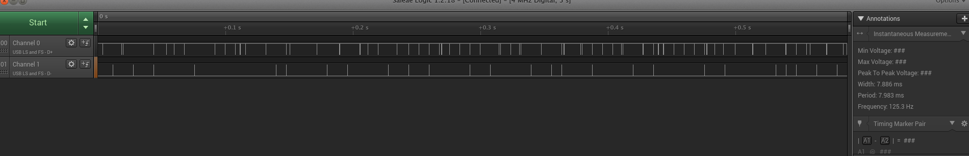

I am working on a project with an end goal of a personal project and also to learn along the way. I am stuck on finding a reasoning behind the following results.
Scenario:
I currently want to use the digitalRead of the Arduino to read the Data +/Data - line of my USB keyboard and digitalWrite to output to a logic analyzer (later on this will output to some kind of system that can parse keystrokes).
My set up is as followed:
Wired keyboard (Data +/-) >> Arduino digital pins 8 and 9 as input >> Arduino digital pins 10 and 11 as output >> 2 channels on my logic analyzer
Note about the wired keyboard. It is connected to another device so it has voltage and ground already. I have spliced the Data +/- lines to my Arduino.
Now I can read the Data lines on my keyboard via the Logic Analzyer alone at 4MHz and parse out the information I need. The end goal is to have the Arduino parse this differential signaling and pass it to other devices. I want to use the logic analyzer for now to make sure the Arduino is getting the correct information needed to replicate.
The issue is when I review the results of the logic analyzer, its crazy! Differential signaling is not there and the HIGH and LOWs appear random.

That is a 3v signal switching at 12 MHz. Differential, so always opposite of each other. Only need to read one oh them, but 3v is almost high enough to be read is as a 1.
Is the logic analyzer looking for 5V signals?
Ok I was curious if I really needed both signals as I was able to decode the HIGH and LOWS to 1 an 0 with 1 signal anways.
So I have the logic analyzer set to 1.8v <> 3.6v. The arduino is 3.3v 8MHz mini pro.
Here is a screen shot showing me capturing the USB from the data lines to logic analyzer. (Showing when I hit the letter "a" on the keyboard)
And here it is when I add the Arduino in the middle.
I don’t know why connecting to an input would drag the signal down. It’s only a 1uA load.
You should use a differential line receiver to convert the differential signal into a logic (bipolar) one. Eventually pullup resistors have to be added to the USB signals?
Also a differential line driver should be used to propagate the Arduino output, else you risk to damage the Arduino or the USB port.
