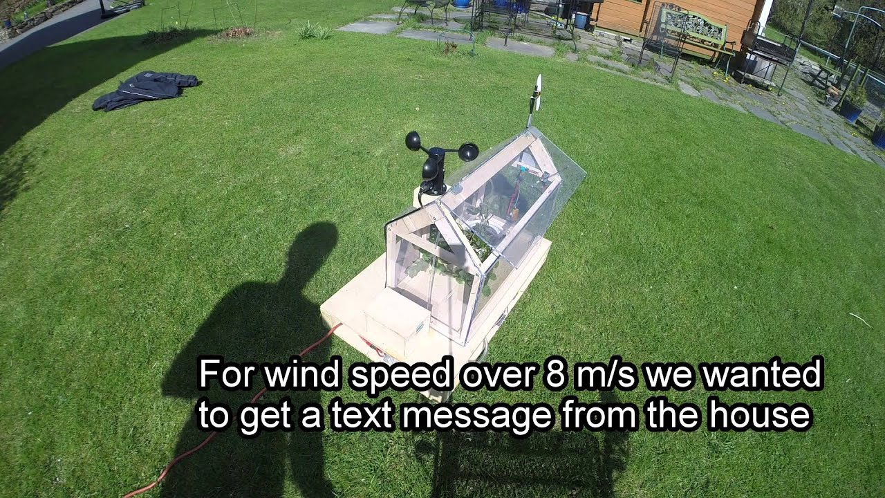

And by the way, I`m familiar with arduino used it before on a school project, take a look:
