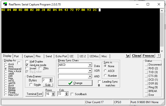

This is the message that GModbus (which can communicate fine with the meter) sends and receives

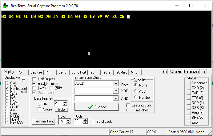

And this is what the Arduino is sending and the reponse I intercept on realterm (when GModbus is not in use)
To me it looks like the message is sent correctly (matches the one sent by GModbus), there is also what looks like a reply
The response is different because I was reading voltage, which continuously change
By reading a more stable value (total import energy) I get exactly the same response between what GModbus asks and what the arduino does
Request: 02 04 01 60 00 02 70 1A
Response: 02 04 04 42 09 99 9A E6 C5
Arduino:

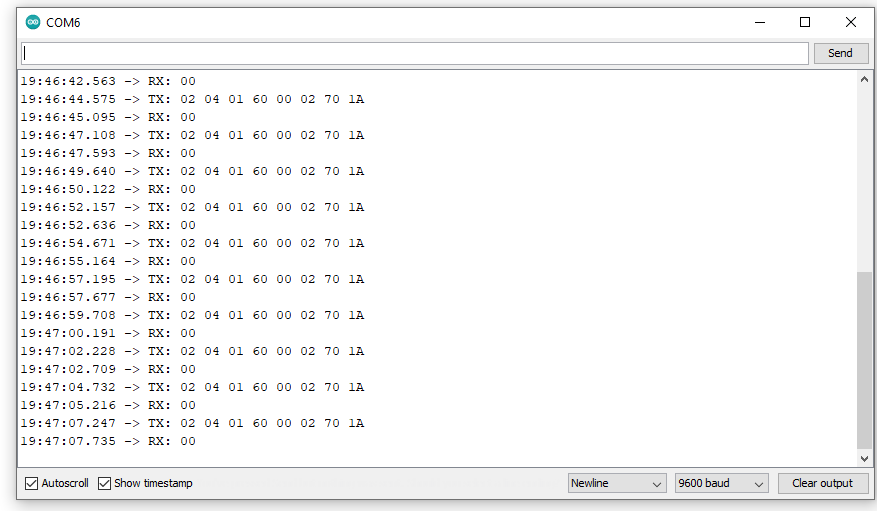

hi, I've tried this and when I connect DE to +5 and RE to 0V, RO is high (4.5V): should it be high or low?
[by the way, with these connections, the response on the serial monitor changes from 226 to 227...]
when I connect DI to 0V, then RO goes to 0V as well;
when I connect DI to +5V (4.5V really) then RO stays at 4.5V because it was already high
That sounds like the RS485 module is working. RO should go high when DI is connected to +5V, and should go low when DI is connected to 0V.
The question now is why your Arduino board isn't seeing the data coming out of RO. Or, maybe it is and the modbus library is going astray somehow.

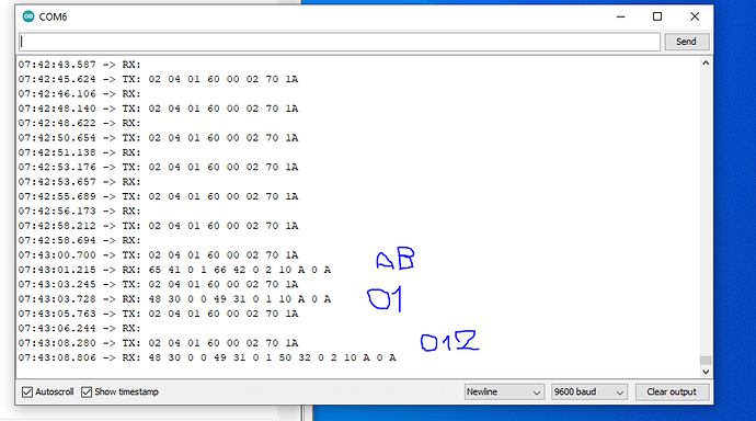

This is a bit of a long shot but it might be worth you trying. Below is some code I have for an Arduino UNO that I use to send out a canned modbus message to a device and then crudely wait for a reply. I've modified the message that is sent so that it sends the message from your RealTerm screenshot in post #28. It compiles but i've not tried it with a simulated device.
// This attempt uses the AltSoftSerial & raw Modbus packets.
// Get AltSoftSerial at https://www.pjrc.com/teensy/td_libs_AltSoftSerial.html
// RS485 module wired up as:
// RS485 DI signal to pin 9
// RS485 RO signal to pin 8
// RS485 RE signal to pin 7
// RS485 DE signal to pin 6
// RS485 VCC to 5V
// RS485 GND to GND
#include <AltSoftSerial.h>
#define RE 7
#define DE 6
// canned message to your RS485 device
// change this for any other canned message you like
uint8_t msg[] = {0x02, 0x04, 0x00, 0x02, 0x00, 0x02, 0xD0, 0x38};
uint8_t rxByte;
AltSoftSerial swSerial;
  swSerial.begin(9600);
  pinMode(RE, OUTPUT);
  pinMode(DE, OUTPUT);
  digitalWrite(DE, LOW);
  digitalWrite(RE, LOW);
  Serial.print("TX: ");
  printHexMessage( msg, sizeof(msg) );
  // send the command
  digitalWrite(DE, HIGH);
  digitalWrite(RE, HIGH);
  delay( 10 );
  swSerial.write( msg, sizeof(msg) );
  swSerial.flush();
  // crude delay for the remote device to respond
  delay( 500 );
  Serial.print("RX: ");
  // read any data received and print it out

Yes, it prints exactly what I expect
I have modified the msg to that it reads the total import energy (34.4 kWh) rather than the voltage; as the clamp is not connected the total import energy is not changing, but the mains voltage was fluctuating (~240V) so at least I always receive the same reply
it receives exactly the same reply that GModbus receives
and the serial monitor is printing this
Hmmm, the software serial port thinks it has received 1 byte. Strange.

This is what I get by typing AB, 01 and 012
When I comment out
with the original connections restored I get
