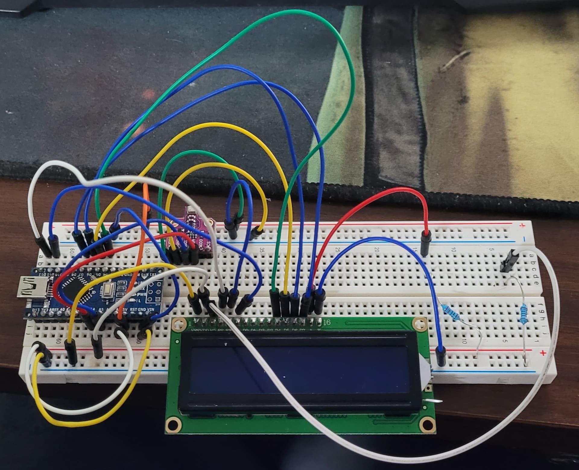

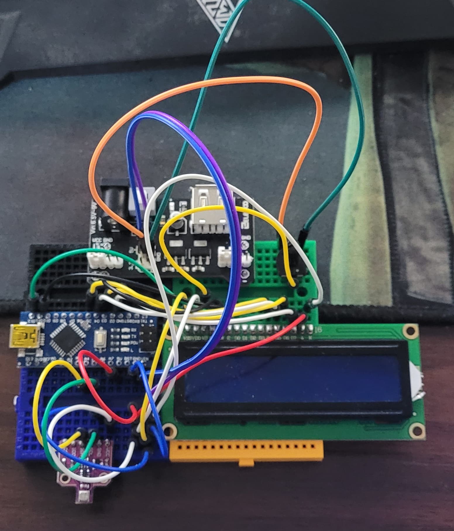

Arduino Nano, BME680, and LCD1602
I rewired some things just to try and take a nice clear picture of all the connections. If there's something you can't see, please let me know.
So I'm sure it's pretty self explanatory, but I'm trying to make an "air quality sensor", and have the readings printed out on the LCD. The code verifies fine, and uploads to the nano, but when I power it on, I just get a wacky assortment of characters.

When trying to fix the display, you should try to isolate that problem.
Can you check one more time the 4 data lines ? I think they are okay in the photo, but a wire could be broken or make bad contact.
Can you show a better photo (or a better link) to your BME680 module ? Is that module suitable for a 5V Arduino board ?
I will make a small/simple circuit to verify the LCD functions correctly, and post the results.
I changed out all 4 data lines, no change.

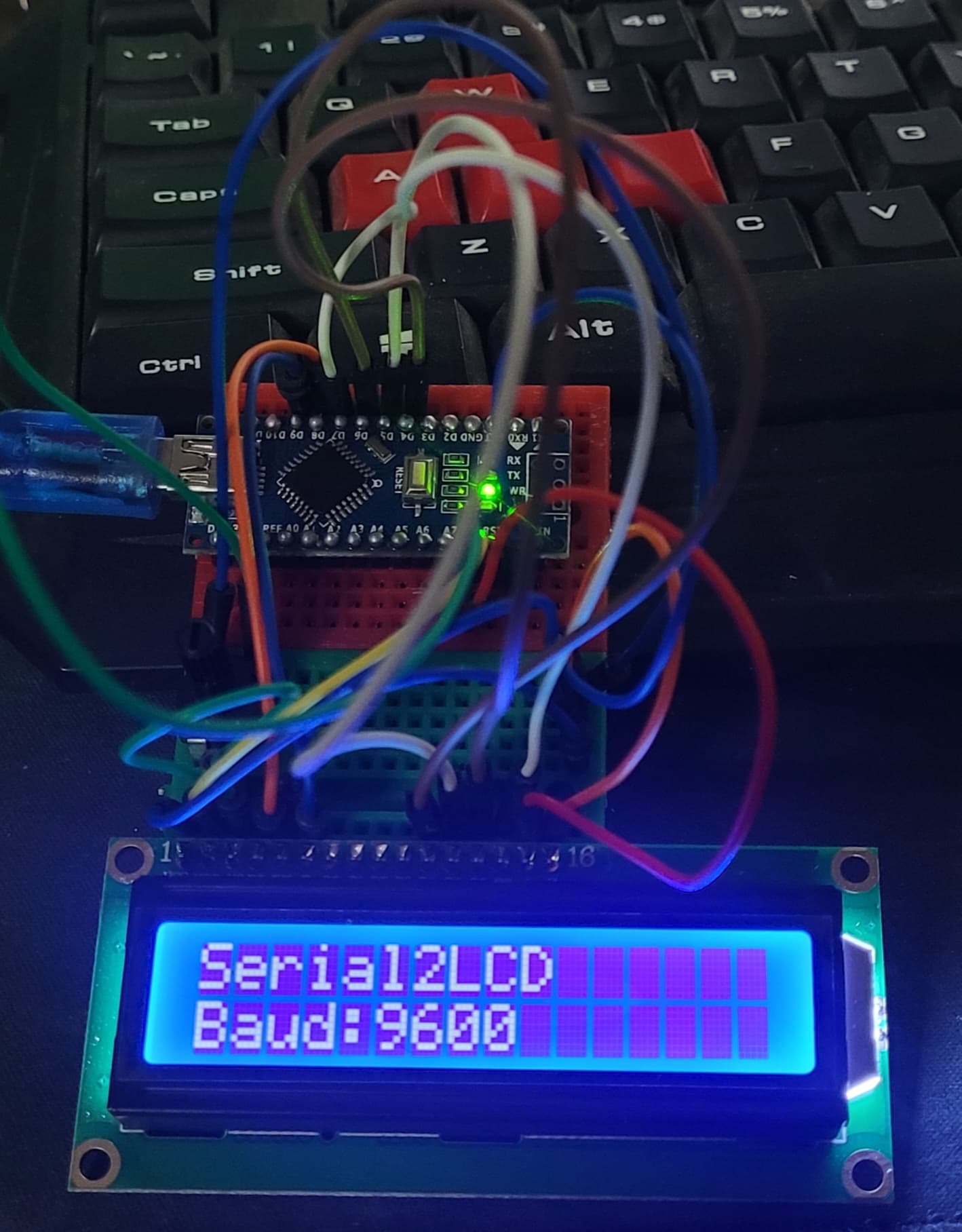

Yes, everything is possible.
I suggest you use Bill Perrys library , installable through the IDE library manager and run the diagnostic sketches included in the examples.
It will self-configure and test the LCD and provide the details via the serial monitor.

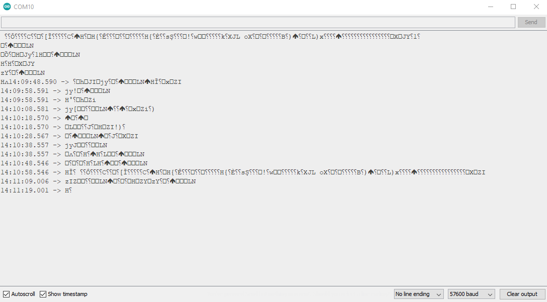

So to start, I decided to test the BME680.
Here's my simple little circuit.
And I used the I2CDemo code from "Zanshin_BME680" library here:

This is what the serial monitor spit out. Which is pretty accurate compared to what the LCD was showing.
This makes me think the problem is not with the LCD, although I guess it wouldn't be a bad idea to test it as well, just to make sure I don't run into another problem.
I forgot to add, I also used a new nano, to make sure there wasn't an issue with the other one.
I think I figured it out, I won't consider myself "out of the woods" until this whole thing works, lol.
I was having a bit of trouble uploading to my nano's. Both of them. I then came across this:
Baud rate explanation
Which goes on to say how official boards changed to 115200, while clone boards are still 57600.
So I went back, changed the baud rate, which was indeed set at 115200. Uploaded the example code again, and here's the monitor:
Not sure what that funny business is on the beginning of the first line, but everything after that is beautiful.
Now to attempt to display this on a LCD...

I know the circuit is kinda hard to see, it's the same wiring as the original.
BME680 is wired I2C (SCL to A5 and SDA to A4)
The LCD is wired RS/D12, RW/Gnd, E/D11, D4-7/D4-7, added a pot.
Nothing prints to the LCD, and the serial monitor stops here.

Okay, so I've completed my first LCD test using Bill Perry's library. First off, being such a noob at this, that was quite overwhelming at first. But I did some reading, read the documentation that came with the library, and I finally realized which one of the MANY examples I needed to try. A lot of them are for I2C, and I don't have one of those breakout boards you need to do that, and a few of them were for very specific LCDs. Either way... Here's my results.

As I said, I don't own one of those breakout board/backpacks for I2C wiring, BUT I do have a 74HC595 Shift Register that I could use for SPI, as seen HERE.
It seems that would open up my options a lot more with Bill Perry's library examples.
Ughh... I am so lost. I can get the LCD1602 to work. I can get the BME680 to work.
For the life of me I can NOT get the LCD1602 to print the output of the BME680. I can get it to print out nicely in the serial monitor, but I just can't get it to the LCD.
Bill Perry's library is pretty extensive, but is way over my head because I just don't really know what I'm doing. A lot of the examples are pre setup code, which again, with my extremely limited knowledge, is completely lost on me.
Sometimes it's really hard to mash 2 existing codes together hahahaha.
