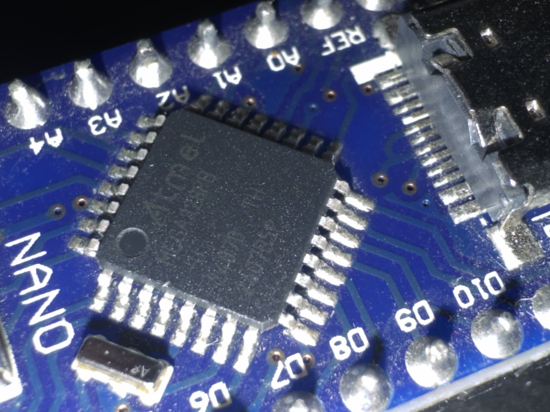

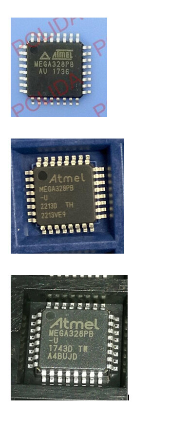

Please post a clear picture of the IC on the top. It should be this

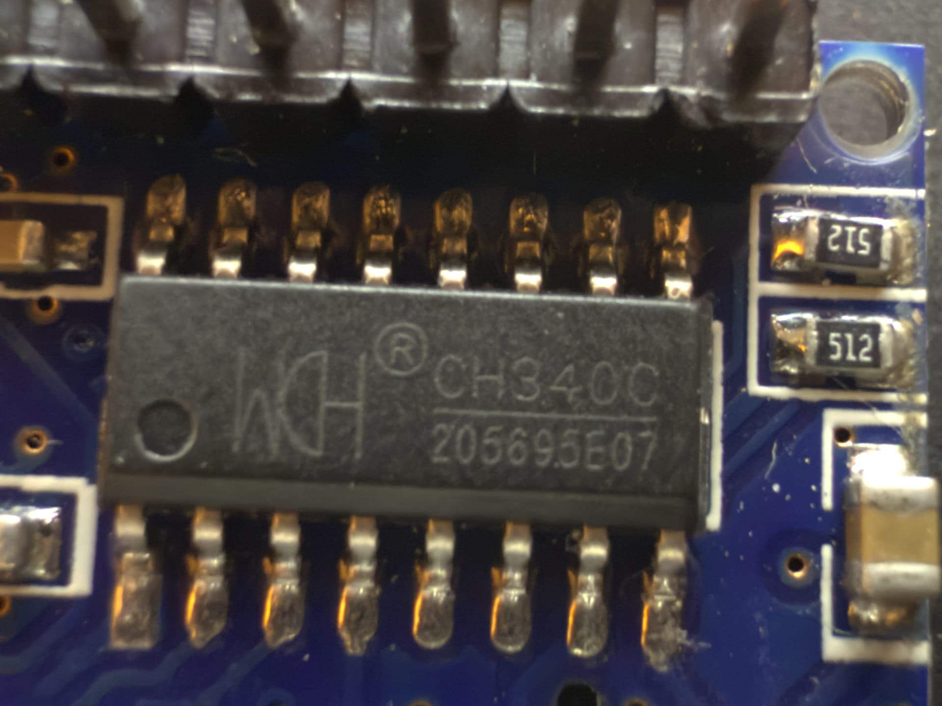

Please also post a clear picture of the IC on the bottom of your board. Is there text readable on it? Which text? Most clones use the CH340 and should look like below.
 ![deb89af271c1ca775189d674b94160108a6ce428_2_999x750](https://europe1.discourse-cdn.com/arduino/original/4X/8/2/e/82e5795c47d30ac6b1fa8c4b643c7db80f0f5352.jpeg)
How does Windows device manager identify the board? As a CH340 or as a FTDI?
If Windows recognises the board as a CH340 and the IC on the bottom is the CH340 (16 pins) and has no print on it you will have to roll back the driver; see [Port monitor error: command 'open' failed: Invalid serial port. Could not connect to COM serial port - #49 by ptillisch](https://forum.arduino.cc/t/port-monitor-error-command-open-failed-invalid-serial-port-could-not-connect-to-com-serial-port/1127713/49).

ok so here is the photos you requested.
 ![IMG_0593](https://europe1.discourse-cdn.com/arduino/original/4X/9/d/a/9daa3a00c4a59c378feec27d14c703c521f3461f.jpeg)
 ![IMG_0598](https://europe1.discourse-cdn.com/arduino/original/4X/8/4/0/8405627a3b2290a2d6ff23a04da5e9b6cbadc2e7.jpeg)
incase its not visible the first image says "atmel mega328PB"
and the other says its an ch340c.

Your board has the 328PB, not the 328P. It would be advisable to use the [MiniCore](https://github.com/MCUdude/MiniCore) board package.

but it's returning the signature byte for the 328P not the 328PB
Hmmm..

All I can say is that the chip is returning the signature for a 328P and not a 328PB. However, the 328PB is not a pin for pin replacement for the 328P.
It may well be possible to execute code designed for the 328P that will damage a 328PB. That may explain why it worked at first but later failed when you tried different code.

If you have a look at the pictures of the ATmega328PB you see a wide variety.
 ![image](https://europe1.discourse-cdn.com/arduino/original/4X/5/a/b/5ab8eb4eb0ccd4264d61480a4505e677c929589d.jpeg)
The middle one is closest to that of the OP in post #7 but the font is a little bolder here. I've not idea which, if any, are fakes.
<div class="post-metadata">
**Author:** ![zenux](https://dub1.discourse-cdn.com/arduino/user_avatar/forum.arduino.cc/zenux/32/1126450_2.png) [@zenux](https://forum.arduino.cc/u/zenux)\
**Post date:** [May 24, 2025, 1:19pm UTC](https://forum.arduino.cc/t/arduino-nano-clone-uploading-code-but-not-running-it/1384038/16 "2025-05-24T13:19:40Z")
</div>
So basically my board is cooked? And there is no way to fix if?
**Post date:** [May 24, 2025, 1:22pm UTC](https://forum.arduino.cc/t/arduino-nano-clone-uploading-code-but-not-running-it/1384038/17 "2025-05-24T13:22:14Z")
</div>
I think the text got less visible by time. I can try to send you a clearer picture or atleast try to tell u the text written if that will help.
**Author:** ![jim-p](https://dub1.discourse-cdn.com/arduino/user_avatar/forum.arduino.cc/jim-p/32/922840_2.png) [@jim-p](https://forum.arduino.cc/u/jim-p)\
**Post date:** [May 24, 2025, 2:49pm UTC](https://forum.arduino.cc/t/arduino-nano-clone-uploading-code-but-not-running-it/1384038/18 "2025-05-24T14:49:58Z")
</div>
> [@zenux](#):
Other than replace the 328, I don't see what else you could do.
Most of the time it's just cheaper to throw it out.
