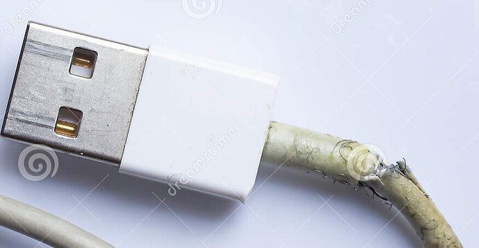

there are bad USB cables floating around. yours might be broken inside and have a short (the 5V wires touches the GND). This could also damage your Mac (but I think the hdmi/usb adaptator might include a protection for that, insulating your USB C port)...
Ok, noted!
I will take the habit to always plug on a standard usb charger any new material/cable.
I prefer to fried a phone charger than a usb port of my mac.
yeah ! although you usually need to plug the Arduino to the USB port to program your arduino... so best to invest in quality cables and recycle them if they show any sign of wear. Don't use anything like this :slight_smile:
