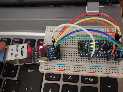

Arduino Nano & ENC28j60
Hello there
I had the same problem some days ago but with a Arduino Uno and a ws5100.
Now I want to send the measurements to a server with a Arduino Nano and a enc28j60.
Still i get the error "0" on the method : "client.connect(mac)" or "client.connect(mac, ip ,dnsip , gateway, subnet)".
Here is my Code:

The IP's are correct.
The connections of the chips i mad like in this picture:
enc28j60 > arduino nano
SI > D11
CS > D8
VCC > 3V3
SO > D12
SCK > D13
GND > GND
I think th eproblem is at my soldering skill or in the code. I checked the sold spots but I'm going to do this again, sine i don't trust them.
Thank you verry much for any help.
