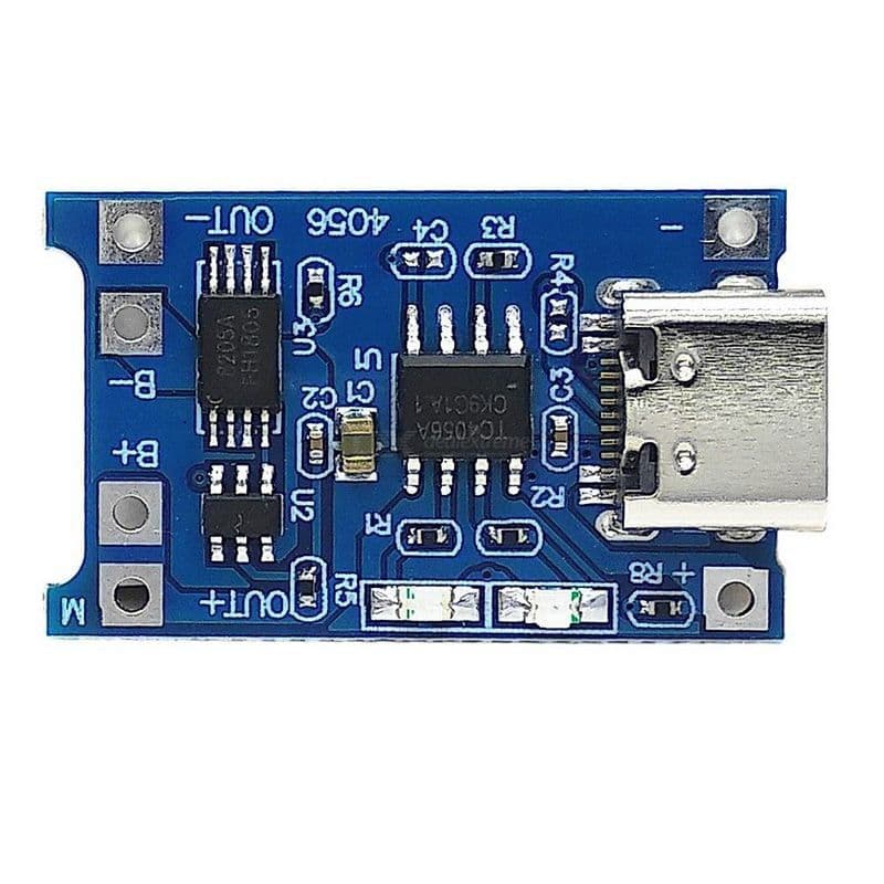

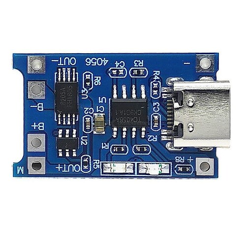

and this is a picture of the TP4056 which i have.

It does not output 5V.
You should not have anything connected the OUT wile the battery is charging.
Not sure exactly what happened but connecting it to the nano was a bad idea.
Did you have the nano connected to a PC at the same time you connected the TP4056?
I had noticed that I was just using an OLED I2C screen and a RTC Module therefore, I had thought that a 3.7V Battery would have worked. The last time the battery was being charged was a day before i had connected the OUT. From what I know, I don't think its possible to connect both the PC and the TP4056 at the same time, the TP4056 OUT + and OUT- was connected to a Mini B, which I connect it to the same socket as the one used to transfer code.
OK now I understand what you did but the Nano is expecting 5V to come through the USB connector. What happens when you connect 3.7V, especially on a clone, is unknown, it just may not work or it may damage the Nano.
In any case connecting the TP4056 probably damaged the nano somehow.

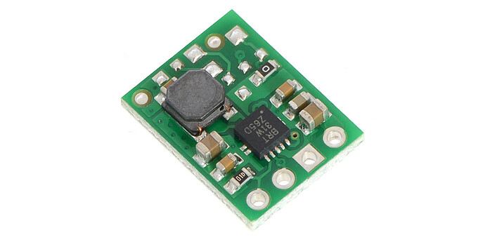

To power your nano from a 3.7V battery you need a boost converter like this
