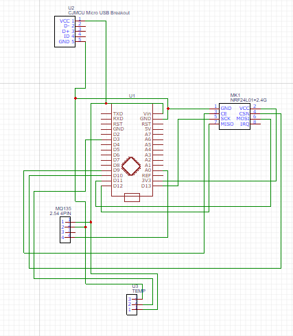

Hi everyone,
I try to first connection btw my NRF24L01+PA+LNA modules but I'm about losing my mind pls help me I checked every single wire over and over again.
Thanks a lot ..
BC
My module :
my connection diagrams :
Server
Client

Read this page about nRF24L01 problems:
http://arduino-info.wikispaces.com/Nrf24L01-2.4GHz-HowTo
Your Server code
RF24 radio(9, 10); // CE, CSN
doesn't agree with the wiring you show.
Don't Double Post. I have suggested to the Moderator to merge this with your other Thread where you have already been receiving advice.
