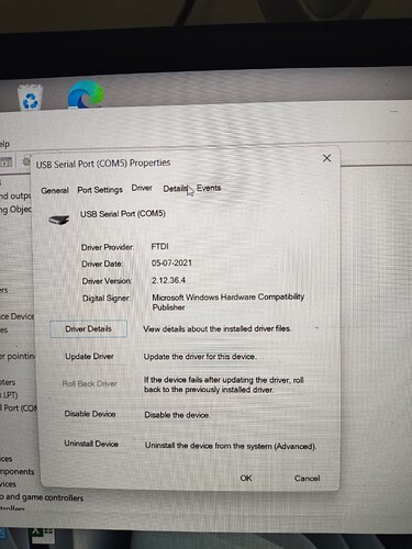

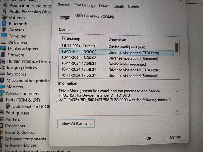

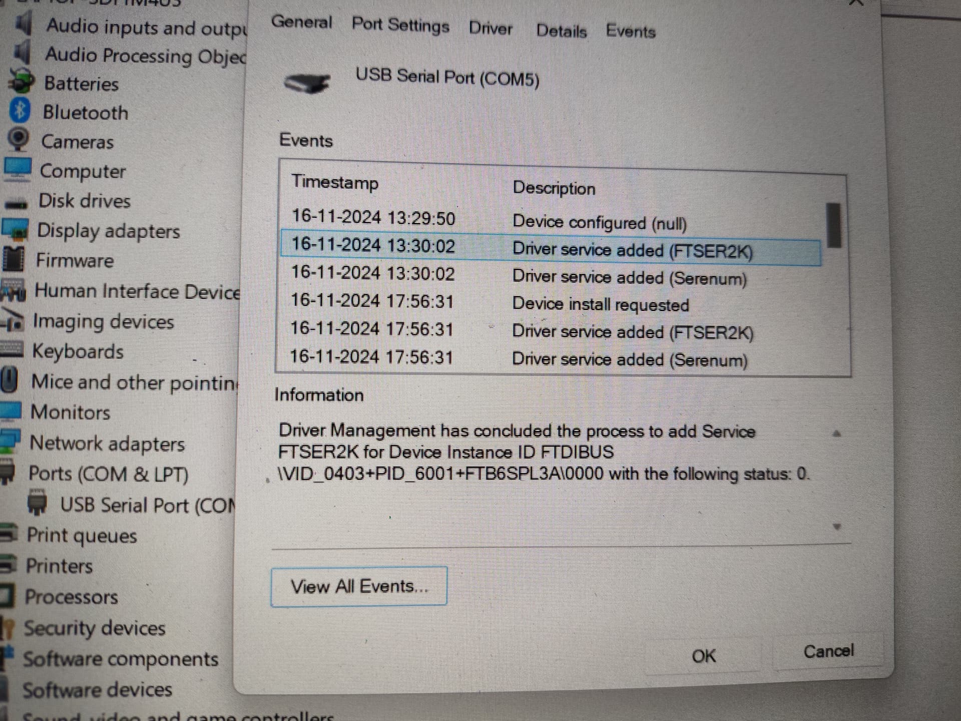

![17318138859885099272229968436208](https://europe1.discourse-cdn.com/arduino/original/4X/2/7/4/274ad19dbd6bdfda599442085294c782a80ab97d.jpeg)
 ![17318139446673406342915092412376](https://europe1.discourse-cdn.com/arduino/original/4X/f/b/f/fbfd4bce9e482cf14fc6fba652f5dd94a9128b2e.jpeg)
 ![17318139680065317232215669109001](https://europe1.discourse-cdn.com/arduino/original/4X/3/7/f/37f87d3918ebb3ce2c8470aa18d66238d551691d.jpeg)
 ![17318140403921566199641282663038](https://europe1.discourse-cdn.com/arduino/original/4X/b/4/6/b46731b3adb7c50aabfa9ed534674400dfdd6977.jpeg)
What should I do in this case as I think the cable is the issue, driver, bootloader also can be the issue as the board is completely fine

> [@arsh217](#):
I think the chip is the issue. FTDI doesn't make the chip with this SOIC-16 IC package, so some monkey business is afoot.
All the "FTDI FT232RL" chips you see on the cheap products from the Chinese sellers (and the domestic resellers of the same products) are counterfeits, but those counterfeits are completely functional. It seems that these strange unlabeled SOIC-16 chips that identify as the `0403:6001` VID/PID pair of the FTDI FT232 and family are either non-functional, or else you must jump through some unknown hoops to get them working, similar to what we have to do with the sketchy unlabeled chips that identify as CH340. Unfortunately I don't have any idea of what might be the procedure for getting these chips working, so I can't help you with that.
My recommendation is for you to contact the seller of this product and request a refund. If you bought it on a buyer friendly marketplace like Ebay or Amazon, the seller will likely just give you a refund without requiring you to do a refund because they know very well that they sold you garbage and are just hoping you won't give them a bad review or report them for selling counterfeit products.

Then I think it will be this one

If it is the WCH CH340, then why is it identifying itself with the `0403:6001` USB VID/PID pair of the FT232 chip:
 ![image](https://europe1.discourse-cdn.com/arduino/original/4X/9/a/0/9a0a595fb6c6e152046b5638d7391293a6e5ab5f.jpeg)
instead of the `1A86:7523` VID/PID pair of the CH340?

The chip's driver is not available for win11 so that's why it is unable to connect

I have a board with a FTDI FT232RL chip and I did not have any issues to get it working in Win11. So a driver for the real chip is available under Win11; the driver might have been installed when you installed the IDE.
I have no idea how Windows will differentiate between a real FTDI FT232RL and a fake one but the fact that you state that there is no driver available might be caused by the fact that Windows knows that it's a fake FTDI FT232RL chip.
You should accept the fact that you have been sold a piece of crap and ask for a refund (as already indicated in post #22).
