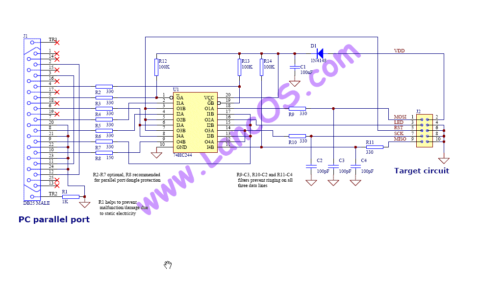

I don't have the schematic in electronic form, but it's this one
minus most of the resistors and caps.
Since I'm a Mac guy, I'd like to build (or even buy :expressionless: ) a serial port version, but I've been just using a windoze box at work for now.
