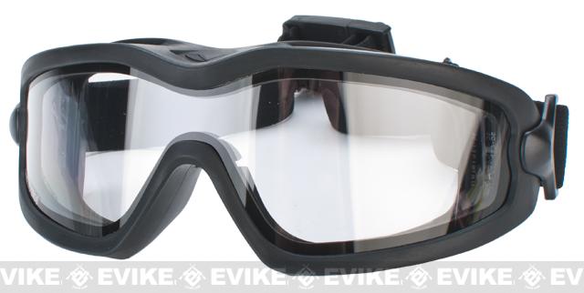

The mechanical parts of this are probably most challenging. Find some goggles that already have the fan in them. (At least, that's what I would do.)

A microprocessor is overkill. Analog circuit would be plenty sufficient. But then again a fan is overkill, imo. A decent dual-pane goggle with antifog treatment won't fog. You can find cheap ski goggles that'll work.
But if your project also has the side effect of you learning about electronics, then great. Just realize you may be throwing more money trying to make cheap goggles work for you instead of getting a decent pair.

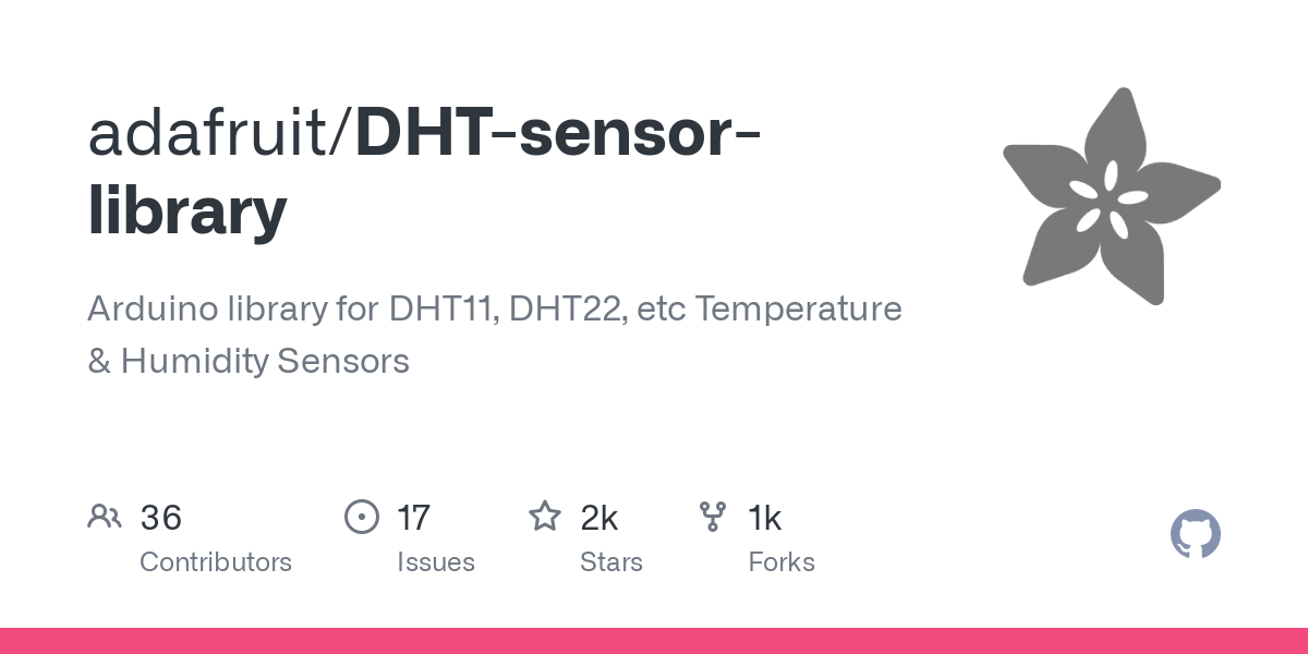

About the sensors you suggested. How do I write code for them? Are there any libraries out there that have built-in functions that return values? How do I know that a specific library will work with my type/brand of sensor? You see, I'm a bit confused since I haven't done anything like this before. If you have any specific examples of such libraries I would appreciate a link - I'm curious to go through the technical documentation.
DanteeChaos:
There are multiple libraries for the DHT sensors. Here's one:
It includes example sketches that will be available at File > Examples > DHT sensor library after you install the library. There is also a link to a tutorial.
