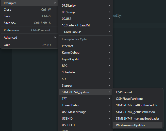

Hi guys,
I’m trying to upload an Arduino Cloud sketch to my Arduino Opta, but it cannot connect to Wi-Fi even though the network credentials are correct. I tried verifying with the STM32H474 managerBootloader sketch, and here’s the output:

Why are Has Ethernet and Has WiFi Module set to "No"?
Hi shokk8448,
Try this tutorial, that updates WiFi firmware. Maybe thats the case.
Alternatively upload sketch WiFiFirmwareUpdater from Opta examples:

Same result.
I had an issue connecting Arduino Opta to Arduino Cloud via Arduino Agent. I tried from another computer, and now it works.
