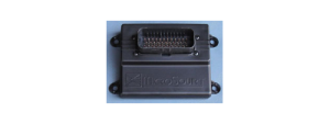

I could not get stable signal to arduino.
Microsquirt is a DIY EFI system, like Megasquirt.
Schematic is not complete, just for showing how I wired pull up, arduino and microsquirt fast idle pin.

jonezy:

Too much to write here, please look at my links:
http://www.megamanual.com/MSFAQ.htm#whatis
I'm sorry, I assumed that mentioning Microsquirt in topic might interest people familiar with it.
