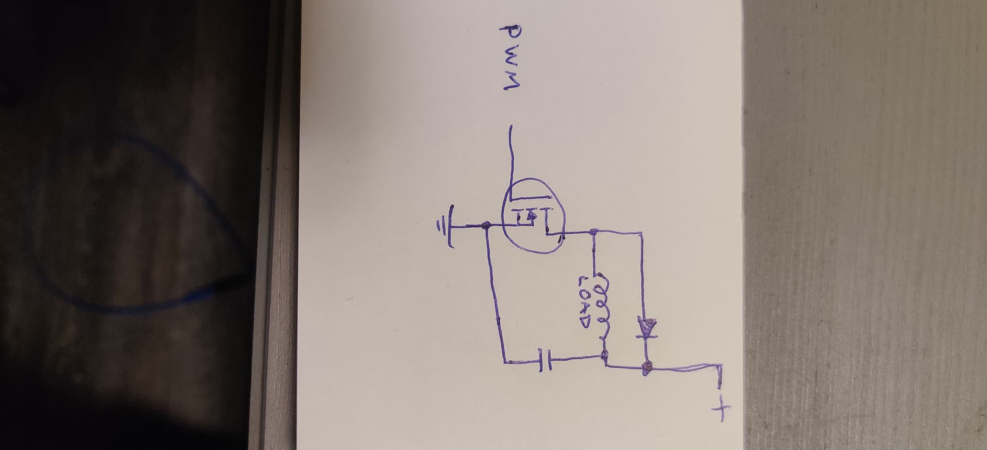

So, you mean i need a cap and an diode on mosfet S-D? It will actually be driving an alternator field coil, trying to build control for motor conversion. I dont think that over 6v on it would hurt it but it doesnt need more. 2-6v should be enough

The diode goes across the coil, the decoupling capacitor across the supply. Nothing goes across the MOSFET source-drain. Example circuit: https://arduinodiy.wordpress.com/2015/12/29/using-fets-to-switch-a-load/
Like this?
Looks good.
Note that using PWM, the current through the coil is - as is intended - relatively constant but the current in the FET, diode and decoupling capacitor is switching rapidly with the PWM. This means that you need to keep the FET, diode and decoupling capacitor as tightly together as possible but the inductor (your field coil) may be some distance away.
A common mistake is to imagine that the diode needs to be close to the inductor; in reality it is important that it is close to the other two components. And of course, for PWM, the diode must be a "fast recovery" type such as a Schottky.
The decoupling capacitor needs to be substantial - at least a few mF (few thousand µF), and rated for the coil current.
