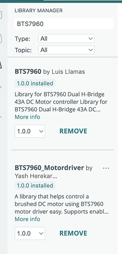

If you search for the BTS7960 module in the library manager you will find 2. Each has one example. Start there.

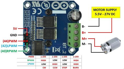

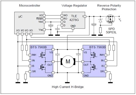

The original BTS7960 module has the power and logic grounds connected. I am assuming this part:
How I assume it is connected:
