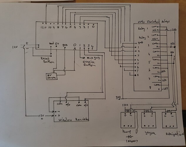

Arduino R3 stops working for some unknown reason.
Works 100% for few hours with no issue but gets jammed up
After a restart everything works again as expected from a-z.
The scketch is to control a water pump mainly and to limit the amount of power(solar power) my house can utilize during the day without draining the solar batteries.
It gets complex as you can see the use of timers.
It appears after reading many topics it is a memory problem.
Any help to help me solve this pls.

const int overrideButton = A1;
const int pumpSignal = A2;
const int waterLevelOk = A3;
// Start outputs
const int warnLowUVsun = 2;
const int sunActiveIndicate = 3;
const int overridePump = 4;
const int tankPump = 5;
const int geyser = 6;
const int irrigationPump = 7;
const int uvStrong = 8;
const int pin_9 = 9;
const int pin_10 = 10;
const int pumpFailed = 11;
