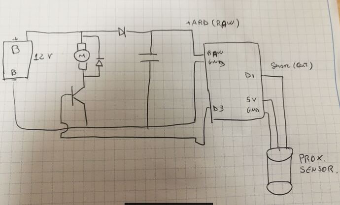

I have a Serious Problem, I make this circuit.
My Aim is: the Dc motor Runs still the Proximity Sensor detect anything, after that the dc motor stops for X seconds.
the problem is that some times (not ever, and not at every time) when the DC motor start it immediately stops and restart.
Now I don't know if:
  1. when the DC motor starts the arduino nano reset;
    or
    2)When the DC motor starts, it causes a lowering of the output voltage from the proximity sensor, and then to the arduino it seems that something has passed in front of the proximity sensor.
This is the circuit.
The code is very very simple, I thing that is a hardware problem, tonight I'll post the code.
the output current of your power supply is probably insufficent
when the motor starts the voltage drops and causes problems with the rest of the system
post your circuit? what is the motor and what is the rating of the power supply?
You forgot to add the circuit.
It's most likely a power issue: either you're powering the motor directly from the Arduino (don't!), or it's surge upon startup is too much for your power supply (get a better one, or at the very least add a large capacitor -
try 220-470 uF - across the supply leads to handle this surge).

OP's circuit:
Vincenzo93:
This looks fine. The cap you use should be plenty big enough.
Vincenzo93:
Stall current at 12 V: 1.2 A
This is probably too much for your power supply. Make sure your power supply can handle this as continuous current without dropping voltage.
I would tend to use a good quality 4amp power supply here with some good decoupling capacitors
My Power Supply is a battery 12 volt 7 AMP/H
But i tried it even on 12 v 100 Amp but it the seems :frowning:
Amp-hour doesn't say anything on current supply ability of a battery, though most batteries will have no problem supplying 1.2A - especially with this kind of capacity ratings (is it a lead-acid battery?). Such a big cap should handily take care of any ripple that the startup of the motor causes.
Is that transistor wired correctly and of suitable type? If that's done wrong, it could be an over current on the pin that causes the reset.

You need to wire your motor circuit DIRECTLY to the battery and the Aduino DIRECTLY to the battery as shown.
Put a FUSE in the positive lead to the motor.
Is your motor wiring heavy enough?
Put a 470R resistor in the base circuit as shown.

TomGeorge:
What is the value of the capacitor?
Tom... :slight_smile:

Can you please post a picture of you project showing you battery connections and motor?
If you look at the image I posted of your circuit, I have the power wires for the motor connected directly/straight to the battery terminals.
The power supply wires for the Arduino are a separate pair going directly/straight to the battery.
This ensures that there is no motor current in the Arduino power leads.
What is the value of the capacitor and the diode?
As your transistor is a Darlington Pair, I would be using a 1K base resistor, even though 10K is working, that part of the circuit can be susceptible to motor noise.
Thanks Tom.. :slight_smile:
10k for the resistor is too high, it may work as you're using a darlington transistor, still better to use a lower value and make sure the transistor base is saturated. Saves a lot of heat production in the transistor. Indeed no shared wiring can also help. Less noise on the wires leading to the Arduino.
1)Tonight I’ll post the photo, now I am away from home.
2)The capacitor is 2200uf 16 volt, (I have tried even with 1000uf 25 volt).
Diode is do41 SR560 5A 60 v
3)How I can fix the noise in that part of the circuit?

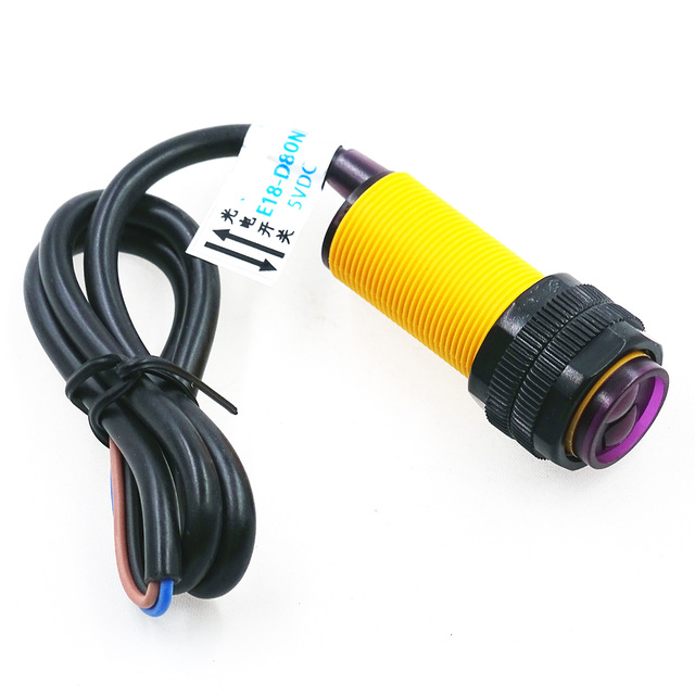

  1. This is the sensor Robot Smart E18-D80NK
  2. · RED: +5 VDC
· GREEN: Ground
· YELLOW: Output: Open Collector Pulldown: Use 10K Pullup resistor to +5V
  1. Normally the output is 5v, and when it detect something the output becomes 0v.
As per the diagram below from the manual for the proxy, it needs a pull up resistor because it is Open Collector.
A 4K7 resistor from it s output to 5V, or turn the pullup resistor ON in the Arduino, using software command.
The sensor alone works well without the resistor, arduino receives all the interruptions, I do not think it is a problem related to the sensor itself, perhaps an interference.
