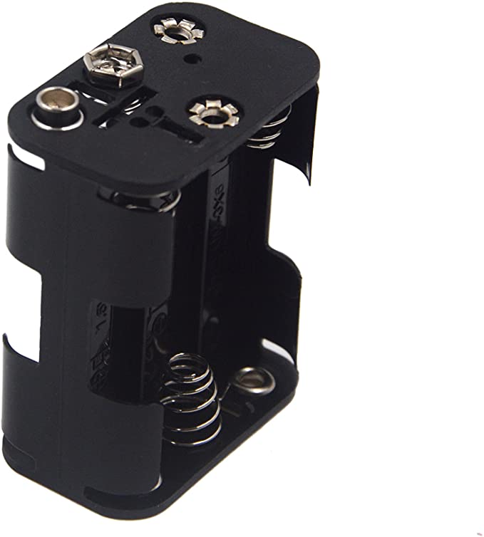

If you must use 9v use 6 AA batteries.

Unloaded motors draw less current than loaded motors. Motors that are starting, briefly, draw a lot more current (stall current) than a running motor. Your 9V batteries can't supply the required current and maintain 9V. The voltage drops too low and the processor resets. Get a battery that can easily supply the motor stall current (see the motor data sheet).
See reply #2.
