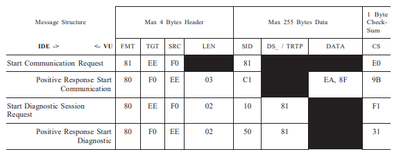

Hello ,
How can I send a Start Communication Request?
Hello ,
Use Serial.write(val)
https://docs.arduino.cc/language-reference/en/functions/communication/Serial/
I am sending it as it is here but there may be errors
Serial.write((byte)0x81);
Serial.write((byte)0xee);
Serial.write((byte)0xf0);
Serial.write((byte)0xe0);
According to your chart you need to send a length (LEN) of zero
Serial.write((byte)0x00);
