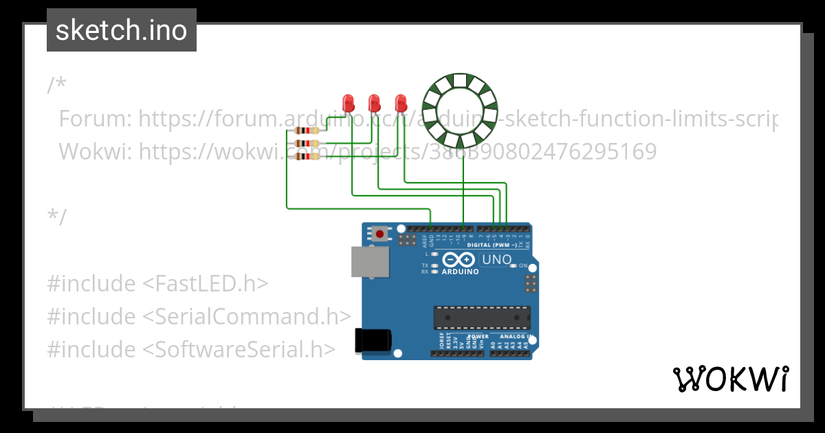

I'm re-visiting Arduino after a long time, so I'm sort of new to it. I'm making a game using Unity keypresses to tell Arduino how to control 3 LED lights, and 1 LED strip. I'm using the library here to help with communications between Arduino and Unity.
The 3 LED lights get triggered to flash on/off indefinitely at diff points in the game, until told to turn off, but should still be able to be triggered to flash again later. The LED strip acts like a "health bar" and can either be emptied (turned off), filled to all green, raised or lowered by one light at a time, or filled to all red and then reset back to green again.
Everything, the flashing LEDS and the health bar strip, was working great - until I added in the last functions to turn the strip red and reset back to green. Then, any button that controlled the LAST LED button didn't trigger its flash - it turned off EVERY light on the setup! Then, after taking away the functions for the red - everything worked fine again - tho of course now I can't turn the LED strip red.
Hence, my fear is my code is getting bloated or messy or overloaded somewhere, i.e. my loop is running too fast or has too much stuff in it, but that's where my understanding stops. My output says the sketch uses 22% of program storage space, and global variables use 30% of dynamic memory.

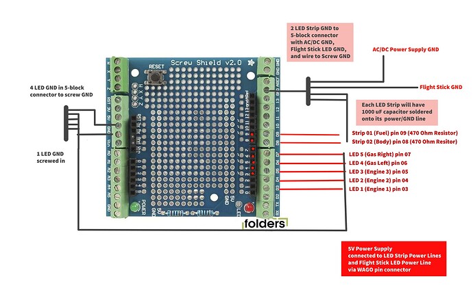

So, my question is, what would I need to better optimize this code? I can send schematics of the circuit if needed too.
