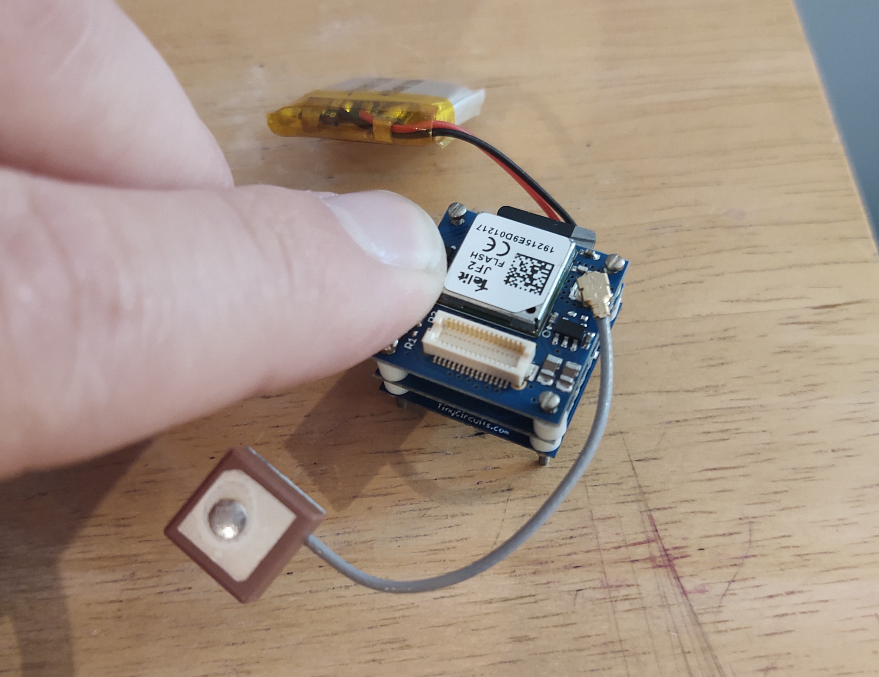

Hello, I'm just using the standard TinyZero board board coupled with their GPS receiver and microSD adapter shields. The setup is powered by a 150mAh battery. Here's a picture:
When I power cycle it, I wait about 10 seconds. I just tried waiting 30 seconds before powering on again, but nothing happened.
