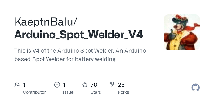

Did you try V4?

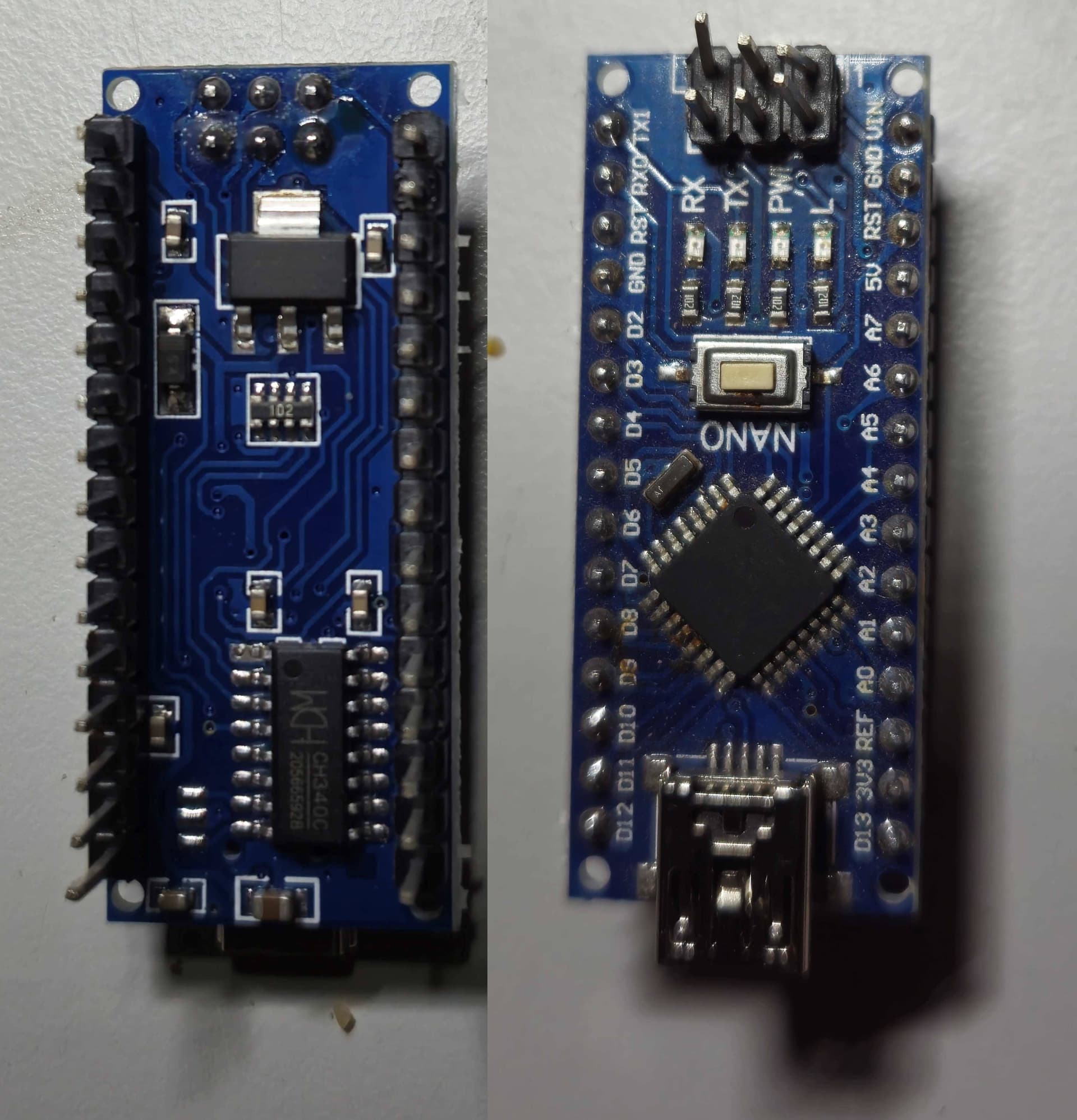

Something wrong with the circuit. That voltage should not be over 5V. The Nano now could be damaged.

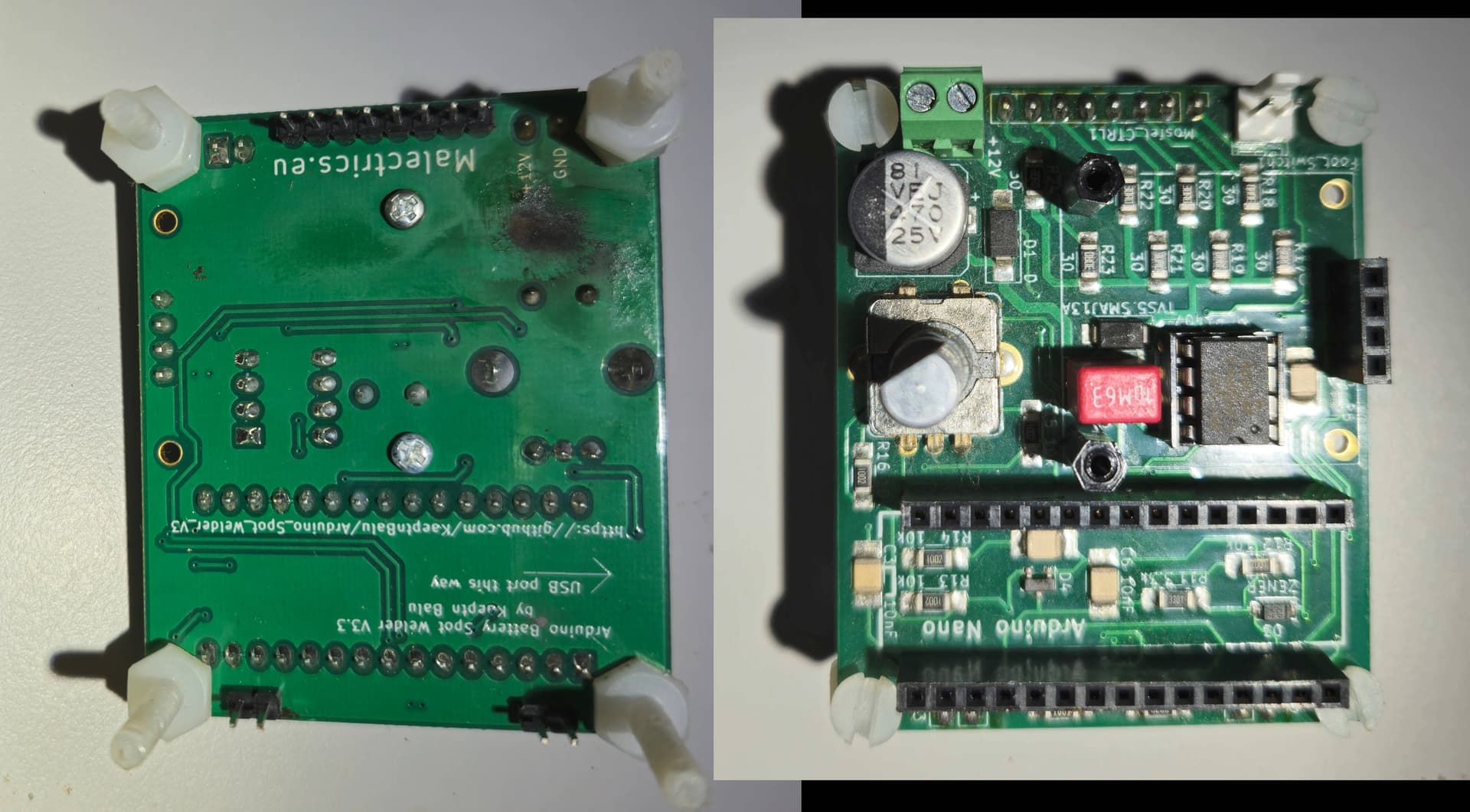

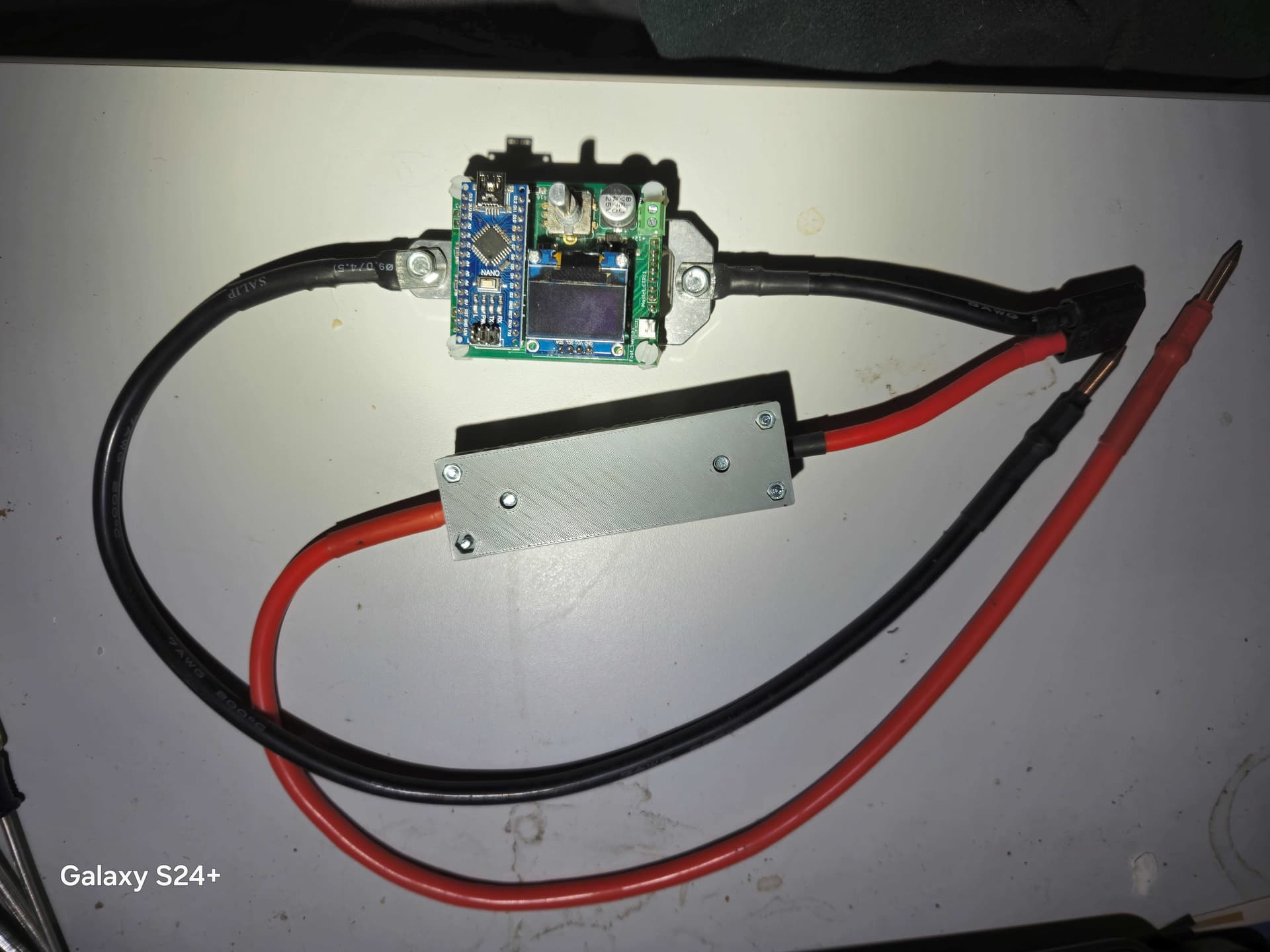

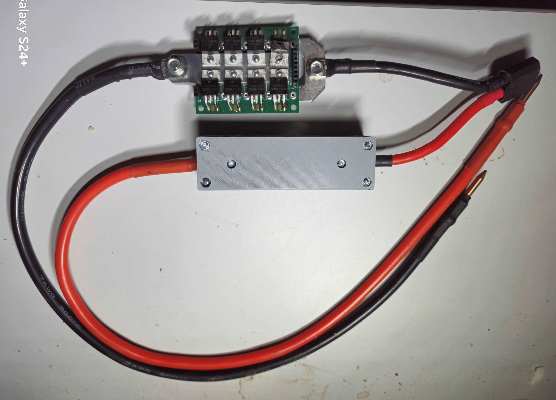

Attached are pictures of the Arduino Spot Welder V3.3

Since I uploaded “HelloWorld”, it displays and peculiarly I now have 4v at A0 I believe the Nano works.
