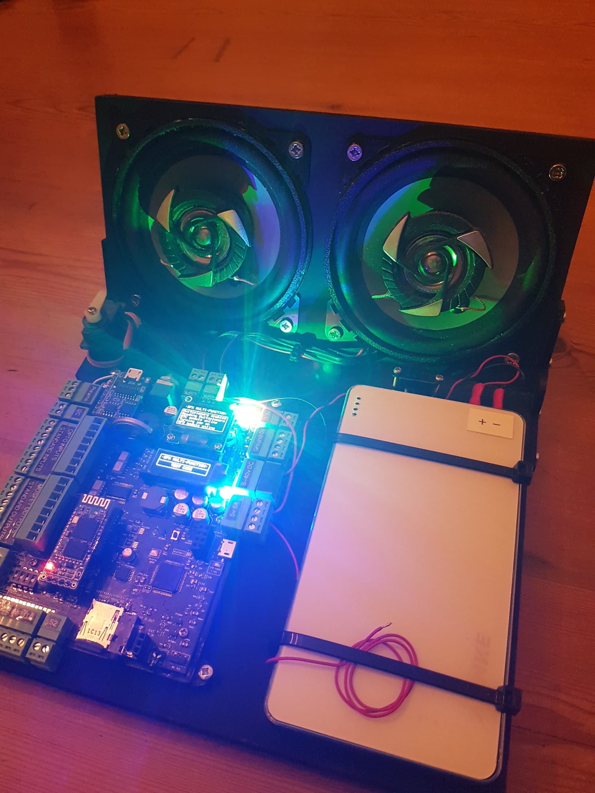

I used to love the 3.2 Teensy. 5v tolerant etc. I made a PCB that had literally all the functions I could ever need a few years back, and then the chip got binned.
No laughing at the ropey soldering... didn't have a heated SMD plate back then

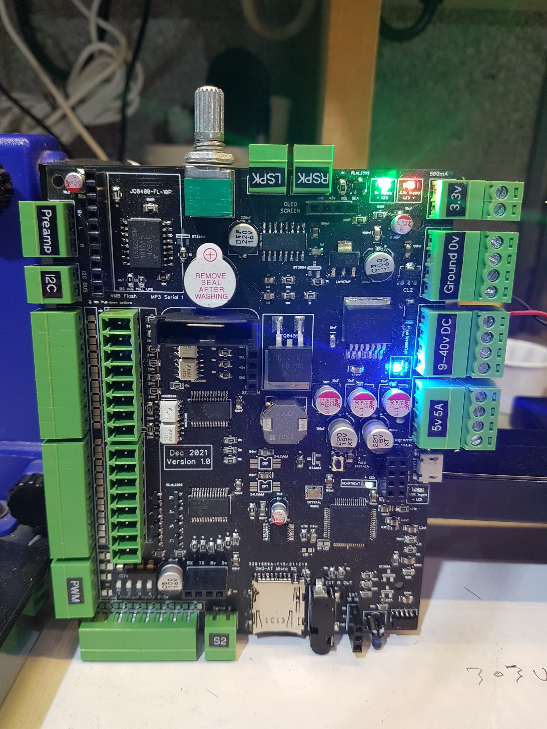

That one (if I remember rightly) was...
9-40v Supply
5v 5A Bus
3.3v 1A Bus
Onboard JQ8400 mp3 module with flash (they are pretty good)
Onboard stereo amp with pre-amp out
Onboard HC06 Bluetooth
Onboard RTC and backup battery
16x digital Inputs
16x digital Outputs (optically isolated)
4x PWM out
8x Analogue in
IR out onboard and remote
IR Receiver onboard and remote
Extra EEPROM memory chips x2
4x Onboard DIP switches for any use
Onboard MicroSD card
Onboard connectors for 128x32 and 128x64 OLEDs.
Can't remember what else. That picture has some of the modules unplugged.
I made a second version that also had optically isolated DMX onboard.
I suspect I am revisiting this!
Shame the processor got discontinued. I am sure could spend a weekend grafting another processor onto that board.
...and amazingly it all worked perfectly first assembly. That never happens
