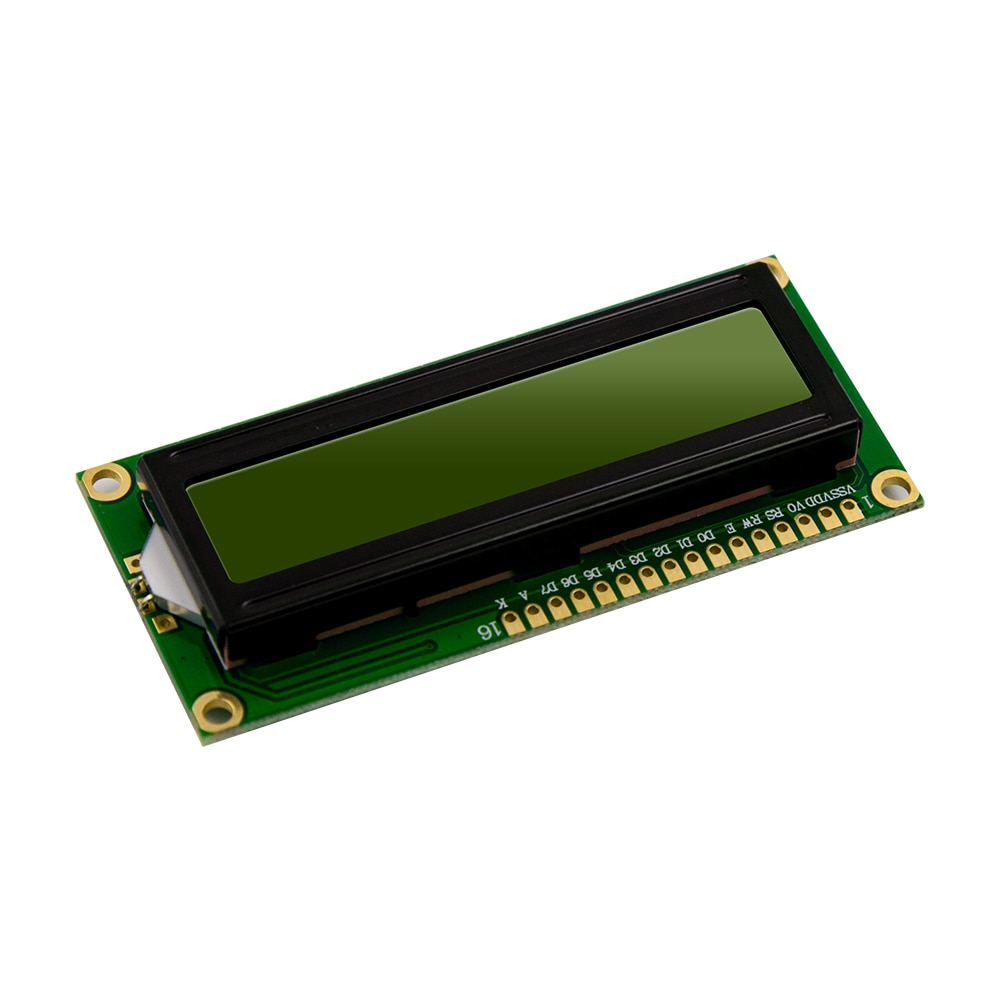

Now if you want it to be adjustable, you will need an indicator. Your choice is between a simple numeric display
or a character LCD.
The next exercise is to learn to display text and your parameters and adjust these using a rotary encoder or just simple buttons. Once that is done, you can put the two functions - parameter setting, and timing - together.
