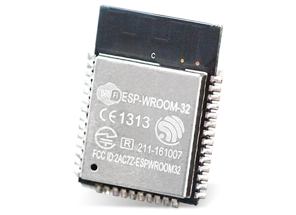

Maybe some inexpensive Esp module could be next step in development (if wireless needed).

kmin, this is an IoT project, so I've been playing around with the ESP32 and NANO IoT 33 along with the UNO R4 WiFi. I really haven't decided on a base for the project yet. Actually, I've been using the UNO R3 but have a couple R4s coming in a day or two.

You could put sockets on your PCB that an ESP32 dev board would plug into. Whether or not that is aprropriate for you depends on:
  • How much other hardware you have that needs to go on the PCB.
  • The comparative costs of using an ESP32 dev board versus buying the parts you need to include the ESP32 directly on your PCB.

There's difference between proto board, dev board and plain Esp module.
Count what you need and find the minimum resources for that.
