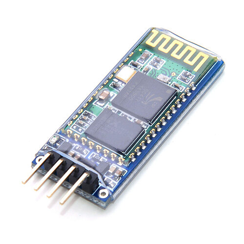

I have a project where I want to connect my Arduino to my phone (HTC Desire C) over bluetooth. I have never tried using bluetooth on Arduino before so I want to make sure that I buy something that will work.
I am trying to send sensor data from the Arduino to the phone. Pairing should be as easy as possible. Would either of these work properly for this and if so, where could I find a tutorial on using it? Or, is there something simpler to use?

No. Look closely you will see that it is bare module, the same as on a shield or a JYT-MCU backboard. Another $2 will see you with the full bottle and it is best to stay way from these.

Again that is a bare module and the same comment applies. It is hard to see where the HM-10 is going. It may be the way of the future, but I don't think its time has come. I understand they keep changing the protocols etc., and it's probably not worth the trouble for an Android user.
A standard JY-MCU is just a few dollars on eBay and is all you need

Look closely at the link you have posted. You will see that the board is a single board with the contacts around the edges like a postage stamp. Check the original lint to ITT eesti. Its the same module but on a shield. Check the JY-MCU on eBay. it is the same module HC-05 or HC-06 but on a little backing board like a sandwich. This enables you to make ordinary 2.54mm pin connections and all the level shifting is done for you. Trust me, stay away from bare boards!

Well, that depends on your soldering skills, but one thing you are missing is the price difference - $2. Why would you do it when you can get it ready to go for $2 extra? Not only that, but for the $2 you get the LED and level shifting circuitry as well. Look closely. It isn't just the header soldered onto the bare module. As I said, it is a sandwich.

That's exactly it. The price is right and you get the cable too. With Android phone, the Android is always the master and the HC-06 should be fine. I have had trouble with my tablet. It won't look at the HC-06 but it is fine with an HC-05. I blame the tablet, it's pretty clunky. Buy the HC-06 or a similar HC-05 for a similar price, and if they have a blank JY-MCU board, buy that too.

I have already told you. It carries the LED and the level shifting circuitry. In case you miss the significance of that, the HC-0x is a 3.3v device and the level shifting circuits mean you can use it with confidence in the 5v world. The peripheral circui9try is on the data sheet.

And in case you have not actually seen one, the smd pads are spaced at 1.5mm, as also clearly outlined on the data sheet, not 2.54 as you would expect, thereby further complicating its installation in the familiar world.
When I say trust me, I mean it. When I say you will regret it, I mean you surely will. This is the voice of experience speaking. If you don't trust me and you think I'm lying when I say you will regret it, at least pop the $3-50 on a blank JY-MCU board as soon as you can, because that will lessen the chances of me saying "I told you so".
Correct me if I'm wrong, but I don't believe it has the level conversions for the tx/rx pins. They are 3.3v. Arduino can accept 3.3v on a pin and it will treat it as if it had been 5v, but it won't work the other way around, you can't pump 5v into the rx pin on the bluetooth modual. A simple 1k/2k voltage divider will fix that

I was just trying to get everything clear in my head and now I believe I have it. I went with this one:
and I expect it to be a fairly simple setup.

I don't think you can go wrong with that choice. I have one the same. It's the right price and it even comes with a cable. Somewhere along I believe it was wrongly identified as an HC-05, but it is an HC-06. You don't need an HC-05 for what you want anyway. Indeed, I have yet to find when an HC-05 will fulfill a perceived need, perhaps when used with a game controller. And don't bother about voltage levels. It's all baloney.
