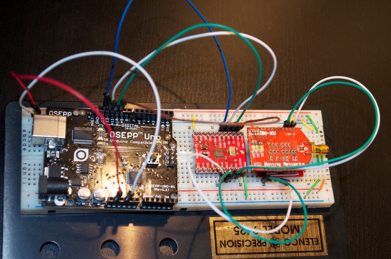

Hey guys,
I have a wifly module (RN-XV WiFly Module - RP-SMA Connector - WRL-11047 - SparkFun Electronics) and have used it successfully using an xbee explorer, but I'd like to use my Arduino UNO to communicate with it. I bought a SPI to UART IC (SparkFun I2C/SPI-to-UART Breakout - SC16IS750 - BOB-09981 - SparkFun Electronics) so I could take advantage of the WiFly libraries that exist out there, but had trouble getting it to work properly. I was wondering if anybody had a reference for the connections needed to get everything working for the Arduino WiFly Driver - Browse Files at SourceForge.net "WiFly Test" sketch?
I had Uno's 10-13 pins connected to CS, MOSI, MISO, SCLK on the SC16IS750 breakout board, and RX/TX going from the breakout board to the wifly module's TX/RX, with both the breakout board and the wifly's GND and VIN connected properly. I have a feeling I have it wired completely wrong but haven't been able to find a good reference, so any help is appreciated.
Thanks in advance.
What is your goal with using the SPI to UART solution? Is that so you can use higher baud rates than using the Arduino's hardware UART or a soft-serial over a couple of digital pins to the WiFly?
To be able to use the soft serial connection.

I'd suggest doing something simple to test the interface first. Like a sketch that simply receives characters from the arduino hardware serial port and sends them straight to the SPI UART interface, and also receives characters from the SPI UART interface and sends them to the hardware serial port. Then you can use the serial monitor and see if you can get the wifly to enter command mode by sending "$$$".
You could also skip the SPI UART altogether and connect two pins from the arduino to the wifly tx and rx pins via a 5V to 3.3v level shifter and use software serial. Or use an XBee shield that supports software serial.
I can't quite work out the VCC connections from those pictures. I think the SPI UART board needs 5V and the Wifly needs 3.3V. Can you describe the all the connections you have between the boards for data and power?
The SPI-UART board is 5v tolerant but works well with 3.3v.
I have the Uno's pins 10-13 connected to CS, MOSI, MISO, SCLK on the SC16IS750 respectively, and RX going from the breakout board to the wifly module's TX, and the TX going from the breakout board to the wifly module's RX. The one thing I think might be weird that I don't understand is I don't have anything connected to Pin 1 of the SC16IS750, labeled I2C-SPI, and I'm not sure what would connect there? Then I have the Arduino's 3.3v and GND connected to the rails of my breadboard, and have the WiFly and SC16IS750 connected to the rails appropriately. Everything has power, but it seems like none of the commands I give the WiFly go through, and I don't see any AOKs come back (or anything for that matter) over RX.
The SPI UART board uses a 3.3V LDO regulator. It's marked X833 so it's probably an SGM2008 which needs an input Voltage of at least 3.6V to operate. 5V would be fine. 3.3V will not work.
From the SPI/I2C UART data sheet...
I2C-bus or SPI interface select. I2C-bus interface is selected if this pin is at logic HIGH. SPI interface is selected if this pin is at logic LOW.
Here's a link to the data sheet
Edit: added datasheet link
I will double check that when I get home and find out if it's not getting power. However, the SC16IS750 gets initialized properly as far as the arduino sketch can tell, based on the following portion of the setup() method

What I really need to do is dive down a little deeper and see what the UART initialization is actually doing under the hood, so I can troubleshoot it better. I wish the WiFly was a little more popular as the Arduino is, so I could find more working references to learn more about what I'm trying to do! Thanks for your help
I have a WiFly module, and I found it easy to use. I didn't bother trying to use a library with it - just the serial interface. I don't think you need the WiFly library unless you plan to change the WiFly config from your sketch.
I posted some details here:
Thanks for the tips. I looked at your sketch and it definitely makes it easier to work with using a soft serial connection. Ideally, I'd like to be able to use the WiFly to the potential it is meant for, which means using a UART signal, but I think I've got quite a bit to learn before I get to that point. Thanks for all the info, I'll let you know if I take it further and do anything exciting with it!
