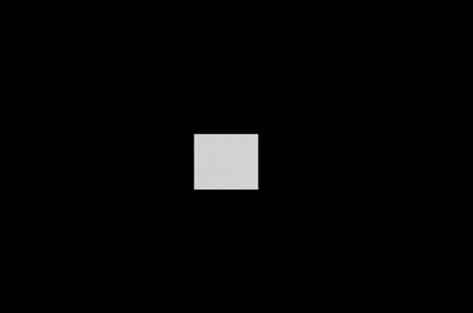

The trouble I am having is using the TVout library outside of the main .ino file.
I believe to use the TVout library I define a TVout object and use the member functions of the object.
The tricky part seems to be getting each implementation file to recognize the same defined TVout object and compile correctly with it.
After a lot of reading around and trying things I managed to make a simplified version of my program, with only one button class, compile. I did this by defining the TVout object as static in the parent class header. This version that compiles, however, seems to behave extremely erratically in the location of the drawing.
main.ino
#include "Button.h"
#include "Rectangle.h"
  TV.begin(_NTSC);
  TV.select_font(font6x8);
  Rectangle midButton;
  midButton.draw(false);

When using TVout in the main.ino file, it works as normal, but when calling a function from a different implementation file, the output doesn't match the program.
In the main file I have two lines that should draw a white box in the center of the screen:
midbutton.draw(false);
and
TV.draw_rect(53, 39, 22, 20, 1, true);
Attached is a screenshot of the image generated with the TV.draw_rect function uncommented, and one with the image generated with the midButton.draw uncommented.
Theoretically these two functions should output the same image, since all midButton.draw does is call the exact same function as TV.draw_rect, except it's stored inside a class instead of being in the main.ino.
You can clearly see, however, that the two outputs are quite different.
I believe that I am doing something wrong regarding the definition of the TVout object, but this is mostly a guess.
What could be causing this fault, and what can I do to try to fix this code?
Thank you in advance for your help
I stopped reading at Button.h
That header file contains:
#include "TVout.h"
#include "font6x8.h"
#include "video_gen.h"
static TVout TV;
These should not be there. Your button.h does not make ant reference to TV/TVout, font, video-gen.
More, the static TVout TV will be included in every file that has
#include "Button.h"
Is this what you want?
I was trying to get that TVout TV into every file, so yes that was what I wanted. The idea was that every class that included Button.h would be using TVout, so I thought I might as well include the TVout liobrary in Button.h. It didn't behave like I expected it too.
I managed to find the correct way to get the same isntance of TVout TV into evey file, so I've found the solution to my question.
In my, now working, program, I define TVout TV in my main.ino.
In the individual button classes, I include TVout.h, and I have the line
extern TVout TV;
This causes the program to compile and behave correctly.

So then you understood the difference between
extern TVout TV;
and
TVout TV;
One declares, the other defines.
